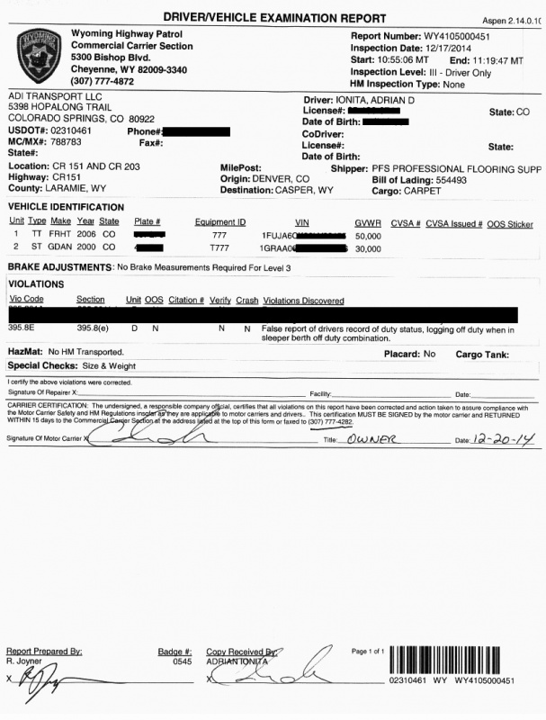

Logging off duty when in sleeper. Yes or no?

    If you take it to court it will get thrown out, This guy was just lookin to bust your chops.

    If the question is whether or not the interpretation in Part 395.1 Question 26 is outdated and no longer valid- The answer is that it is still there in the latest version of the regs and IS valid.
    Question 26: May a driver record sleeper berth time as off-duty time on line one of the record of duty status?
    Guidance: No. The driver’s record of duty status must accurately reflect the driver’s activities.
    This is the guidance that I am required to follow while doing inspections. I have noted violations of this rule in the past and will do so in the future. I can't make up my own rules and this one is pretty simple.
    I have seen MANY drivers log off-duty and sleeper incorrectly and hurt themselves. I can't tell you how many drivers I have inspected that have logged 9 1/2 hr off duty periods and I have had to place them OOS for being over their hours.
    The best and easiest thing to do is log what you do. I've seen many drivers make up stuff and get confused on the details and end up sitting it out for 10 hrs OOS. Telling the truth is easy. Cheating can be hard to do and cover your tracks completely.

    ok, heres the question. lets say the guy logs 10 hours off duty. he is legal , correct?
    if you ask him were you in the sleeper berth any of that time? he says no, he is still legal.
    if you ask him were you in the sleeper any of that time and he says yes, then he is illegal, yes?
    the only way you got him illegal is if he tells you he was in sleeper and has logged it all off duty, right
    what way would you have to prove the difference between sleeper berth and off duty?
    that is in essence the real question of this thread, I do think.
    if someone stayed awake his entire 10 hour off duty, would that be legal as long as it was all off duty? it would be a stupid but technically legal I would think.
    I think you next to last sentence says it all, "get confused on the details and end up sitting it out for 10 hours". without that confusion , theres really no way to differ between the two lines on the book, is there.

    ok, heres the question.lets say the guy logs 10 hours off duty. he is legal , correct?
    It depends upon if he DID what he Logged.
    if you ask him were you in the sleeper berth any of that time? he says no, heis still legal.
    Then he would be in violation per the federalInterpretation. It would be a false log / generally not OOS.
    if you ask him were you in the sleeper any of that time and he says yes, thenhe is illegal, yes?
    There are provisions in the regs that address leaving the sleeper forshort periods of time that would logically apply to going into the sleeper forshort periods of time.
    the only way you got him illegal is if he tells you he was in sleeper and haslogged it all off duty, right
    He is in violation when he logs sleeper berth while off-duty. Obviously I won't put down the violation if I don't know about it. I often findout about it when they log something that hurts them. Say they log 9 hrs ofoff-duty and they tell me it was actually sleeper. If I don't find outabout it, I don't worry about it. It's not a big deal either way. But if I do find out a violation has occurred, I put it down.
    what way would you have to prove the difference between sleeper berth and offduty?
    Not sure what you're asking. If a driver tells me he logged onething and did another, I take his admission as "proof" a violationhas occurred.
    if someone stayed awake his entire 10 hour off duty, would that be legal aslong as it was all off duty? it would be a stupid but technically legal I wouldthink.
    It does not matter if one is "awake" or asleep. All thatmatters is where he is physically. If he is inside of a sleeper berth asdefined by 392.2 he should log sleeper berth.
    I think you next to last sentence says it all, "get confused on thedetails and end up sitting it out for 10 hours". without that confusion ,theres really no way to differ between the two lines on the book, is there.
    Sorry - again I'm not sure what you're saying. If you are in a sleeperberth that conforms to 392.2, you log sleeper. If you are at home, etc,log off-duty. You can log part sleeper and part off-duty if that's whatyou did and get your 10 hr break if it is consecutive.
    I see a lot of drivers throwing in a 15 minute on-duty period in the middle oftheir 10 hr break that gets them in trouble because their 10 hr period is nolonger consecutive and may mean that they have to get lay down for another 10hrs to reset their hrs.
    Again - If you are in the sleeper log sleeper. If you are at home, log off-duty. I guess I'm not seeing why this is such a hard concept to understand?

    It's just ridiculous that this is even an issue. 10 hours off duty or 10 hours in the sleeper accomplishes the same thing. What difference does it make? Honestly, it's just another bull crap rule to gain revenue. It should only matter if you are using the split sleeper provision. I reset my 14 hours. i was in and out of the truck numerous times in that 24 hour period. It's ridiculous to expect someone to go from sleeper to off duty every time they go in and out of the truck. That's just my opinion. FWIW, if I was a DOT inspector I would never write this up.
