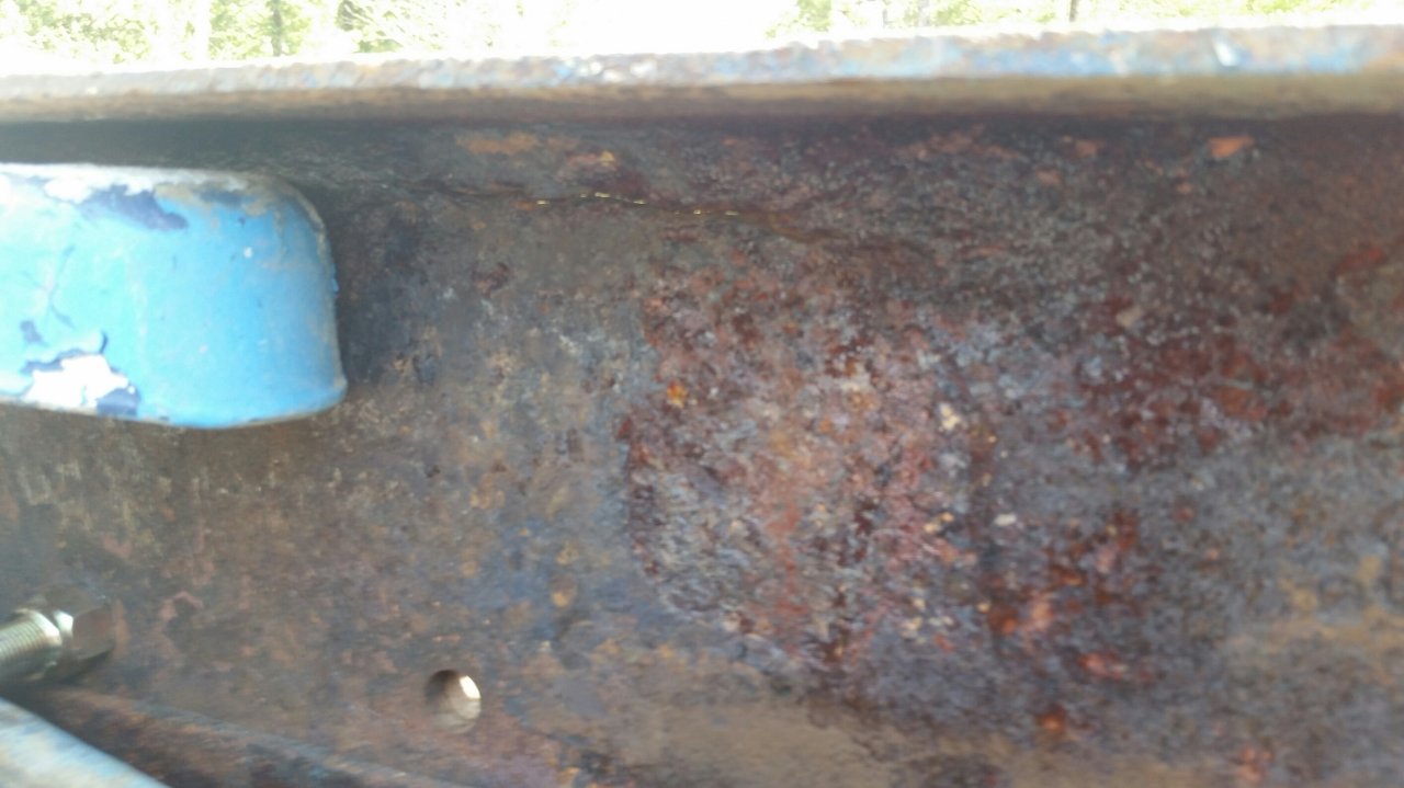

    Here's a few cracks for ya. I think its a combination of overloads and neglect. Being 36 years old doesn't help either lol.

  5. MACK E-6
    48,790
    225,511
    Looks like you torched something out of that first pic. What used to be there?
  6. AModelCat
    29,155
    158,579
    Crossmember in front of the forward diff. It actually runs down to just about the flange and about an inch above the hole. Part of the reason I went for new rails.
