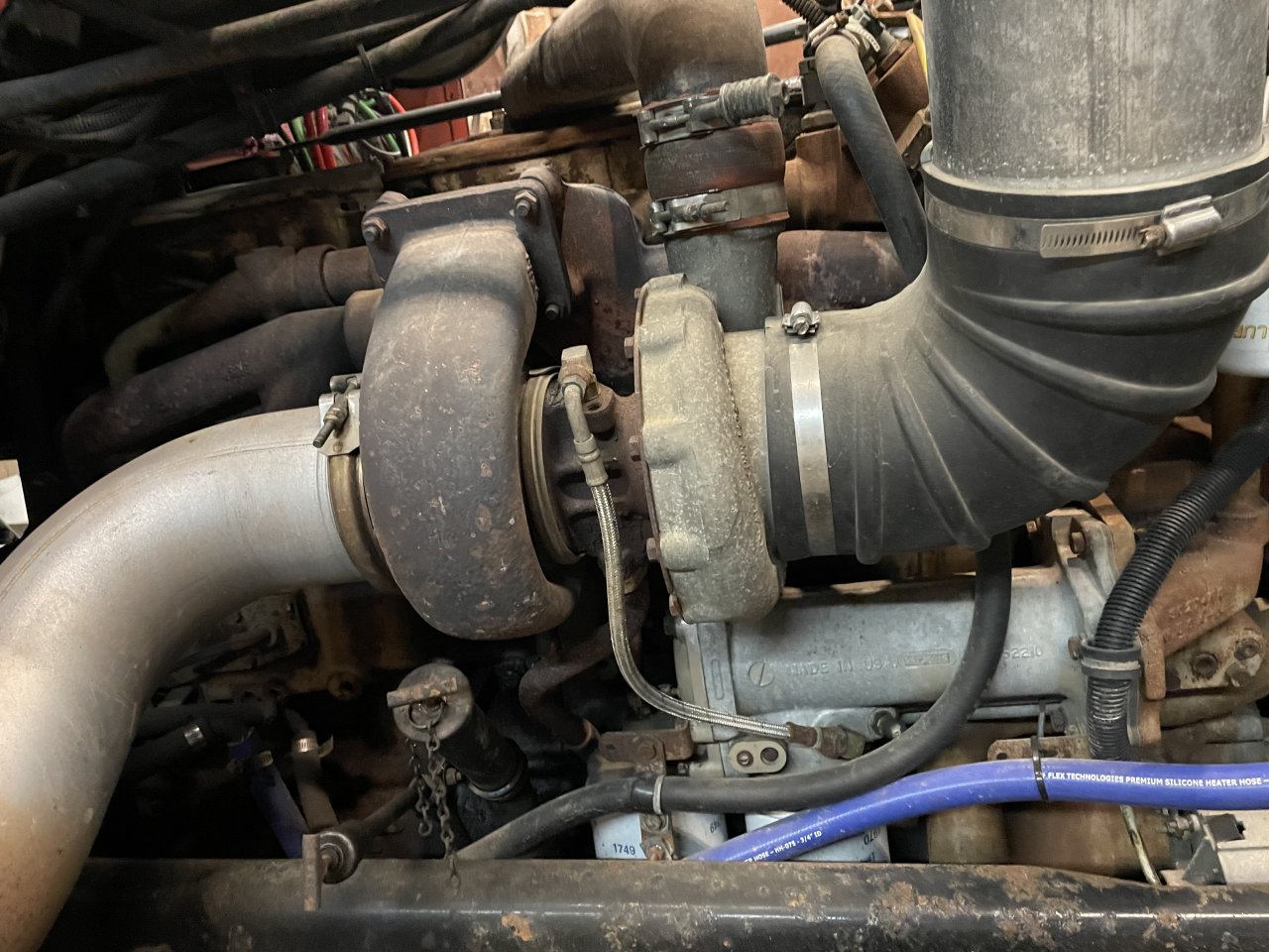

    D2007F41-D2B5-4D5E-B64F-2AB68771F1AD.jpeg Took forever to get her home, finally…
    Found out today it has 3k mi on new “generic bone stock” aftermarket injectors. 595.99 for the set of 6. Yippee skippy :-( they think they might be dual barrel tho?
    took some pics of the engine bay
    smokes pretty good cold, but starts runs shifts drives nice!
    thoughts?

    Kinda interesting that it’s got an old style canister fuel filter

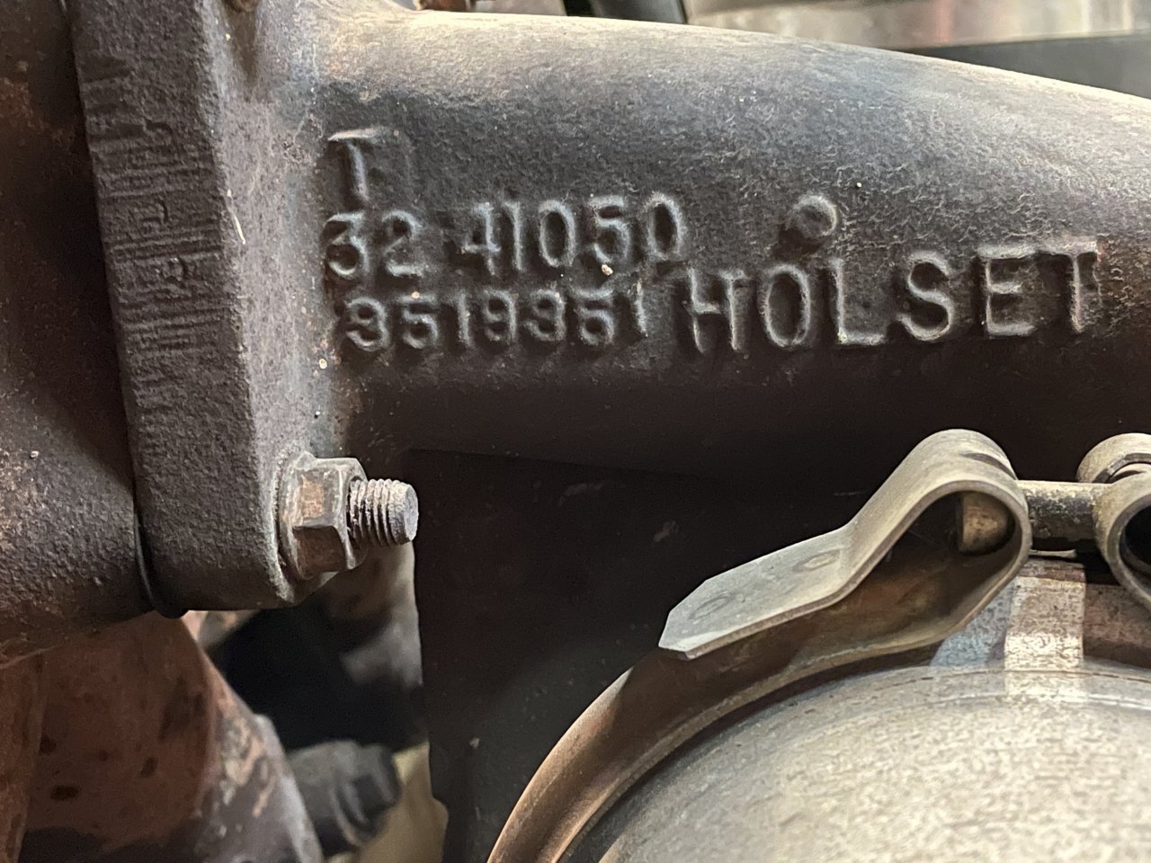

    That turbo can’t be to old either
    I still think the air to air is worth it I have done it to both a big cam and a small cam and It made a difference in how they pulled. Exhaust temp also came down to until I added more fuel. I know it was mentioned that they are made to run on warm air and I would agree that the trucks I have switched smoke a little more when idling in the cold but it’s no worse than my 290 with no cooler. Never know on the aftermarket injectors might be great or might last a couple runs
    Did they say what brand
    sodbuster59 Thanks this.

    You bet! I bought it on a friends voucher for the seller, site unseen, so when it turned out to be better than advertised I was happy beyond belief. There's STILL honest folks out there!!

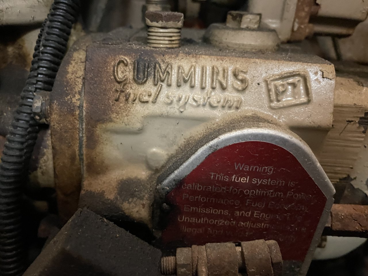

    I'll have to call spencer diesel to see if they can track that down, but I thought I'd wait to bother them till my buddy can open the pump to see how it's set.
    Running warm is one of the things I'm thinking I want to be proactive on, so regardless what happens, if I push more fuel to it, I'm budgeting $ to keep it running overly warm. On the fuel filter, I'm toying around with installing one with a see-thru element, but they're not bashful about charging for them either!
    I've got a few weeks of hauling corn once the crop is planted so will see how it pulls before getting radical.

    Might just check fuel pressure first
