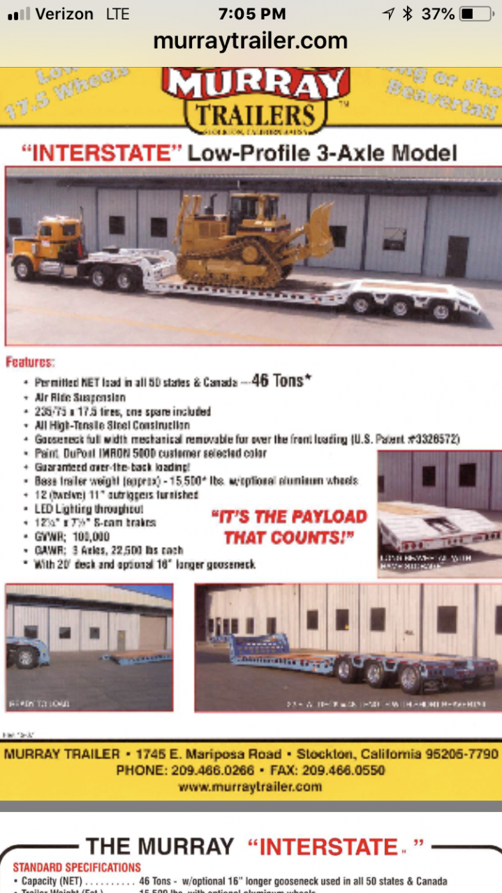

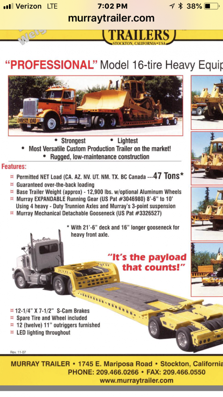

    They also have a different version that is a 32 ton version
    They say tare weight of 10-12k

    And 15120 or so as a 3 axle

    Don't see any of those Murray's in these parts. That's pretty impressive, a 50 ton trailer than weighs 13,000 lbs.
    I guess maybe laws are different out west, but I don't see the reason to be overly concerned with that light of a trailer on anything bigger than a 35 ton. More than likely, when you get beyond a 35 ton rating, you're going to be hauling permit loads anyway, so a little heaver trailer doesn't make that much difference. Our 3 axle 55 ton Talbert weighs right at 24K empty.
