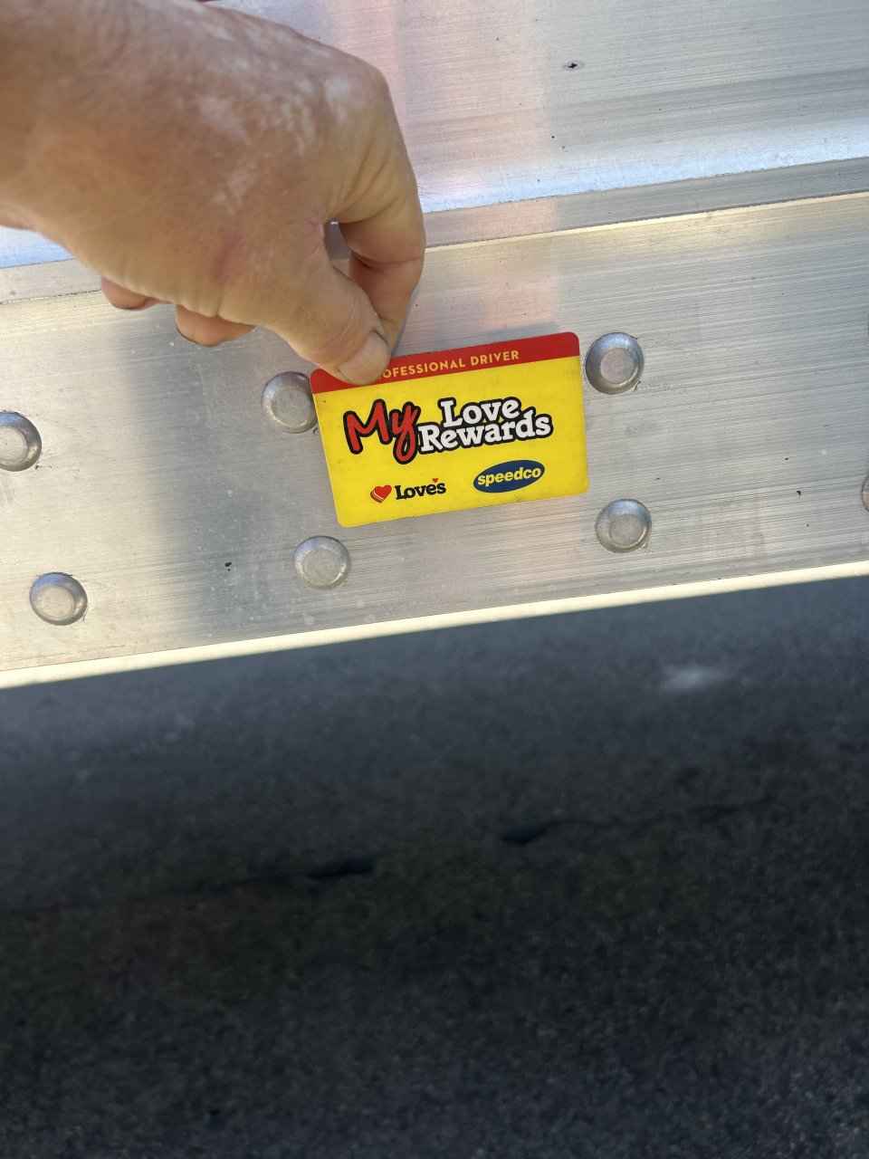

    37BA3AED-E482-45C6-9353-B721183E1054.jpeg CF572420-6292-4900-BF29-5E0FACF49F2E.jpeg 553C75C8-6C0E-4D99-9A03-8600A9D2A3C1.jpeg . I can’t get over this Great Dane parked next to me. Look at how close the cross members are compared to mine. That’s what’s needed for heavy Loads like paper rolls ( which I still wouldn’t haul ) Other loads such as aluminum ingots. They load them 2 at a time, 4000 lbs. using a forklift that weighs 10000 lbs. or even water, loading 2 pallets at a time, totaling 4000 lbs plus forklift. Tears floors up. Makes them weak. This GD could really handle the job, and last a very long time. Well worth a few extra $$ upfront. If needed you could run that Trailer well beyond 10 years without any floor problems.

    New trailer is definitely the way to go, but every once in a while when you see an old super 2 rolling down the road, it’s usually mounted on the front of a Great Dane, utilities work great for fleets that never haul anything heavy and love cheap #### but when you start getting into weight that will make a RGN guy blush with the LTL they just don’t hold up between doors and floor, I won’t even run my trailer with out the bulkhead up

    Wall posts are awful far apart. I'd rather have them every 12" added plus there for freight securement too.

    I agree. Mine are every 24”. Seems good enough. Didn’t know 12” was available. That’s even better. My current focus is on floor I beam spacing, because mine are weak. Nothing beats ordering exactly what you want and running new equipment. One less hassle. Load of dog food tomorrow requires a good food grade Trailer. Lol.

    Great for decking if you need it. That Dane almost looks like one of those flimsy weak, worthless plate trailers that Utility, Wabash and others build. GD doesn't manufacture any plate trailers it's just a sheet and post on 48" centers.
