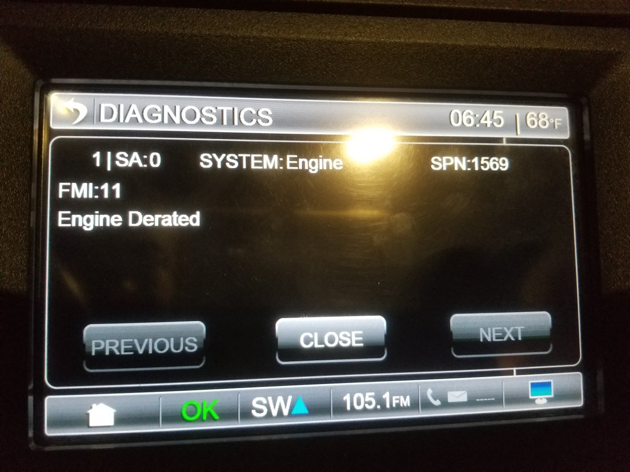

    What CODES are showing? Once you are on the touch screen , go to TRUCK, DIAGNOSE, It'll show some codes ...something like.. 20181106_062057.jpg
    I kinda have the same problem you're mentioning...is this what shows at your screen??
  6. Gzusgardey
    Gzusgardey Bobtail Member
    3
    Sep 1, 2017
    Hello, actually my check engine light is off and i don't get any codes on my dashboard.
