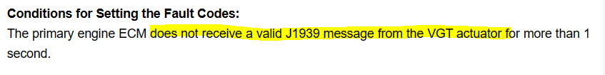

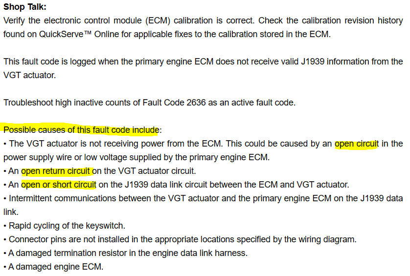

  6. JB7
    JB7 Heavy Load Member
    860
    1,392
    Dec 13, 2022
    Laurel, MD
    In simpler terms, The ECM is not getting a signal from the actuator (not communicating) due to the most likely issue of a wiring problem, corroded, broken, shorted to ground. Note that a bad actuator is not one of the Possible causes of this fault code.
