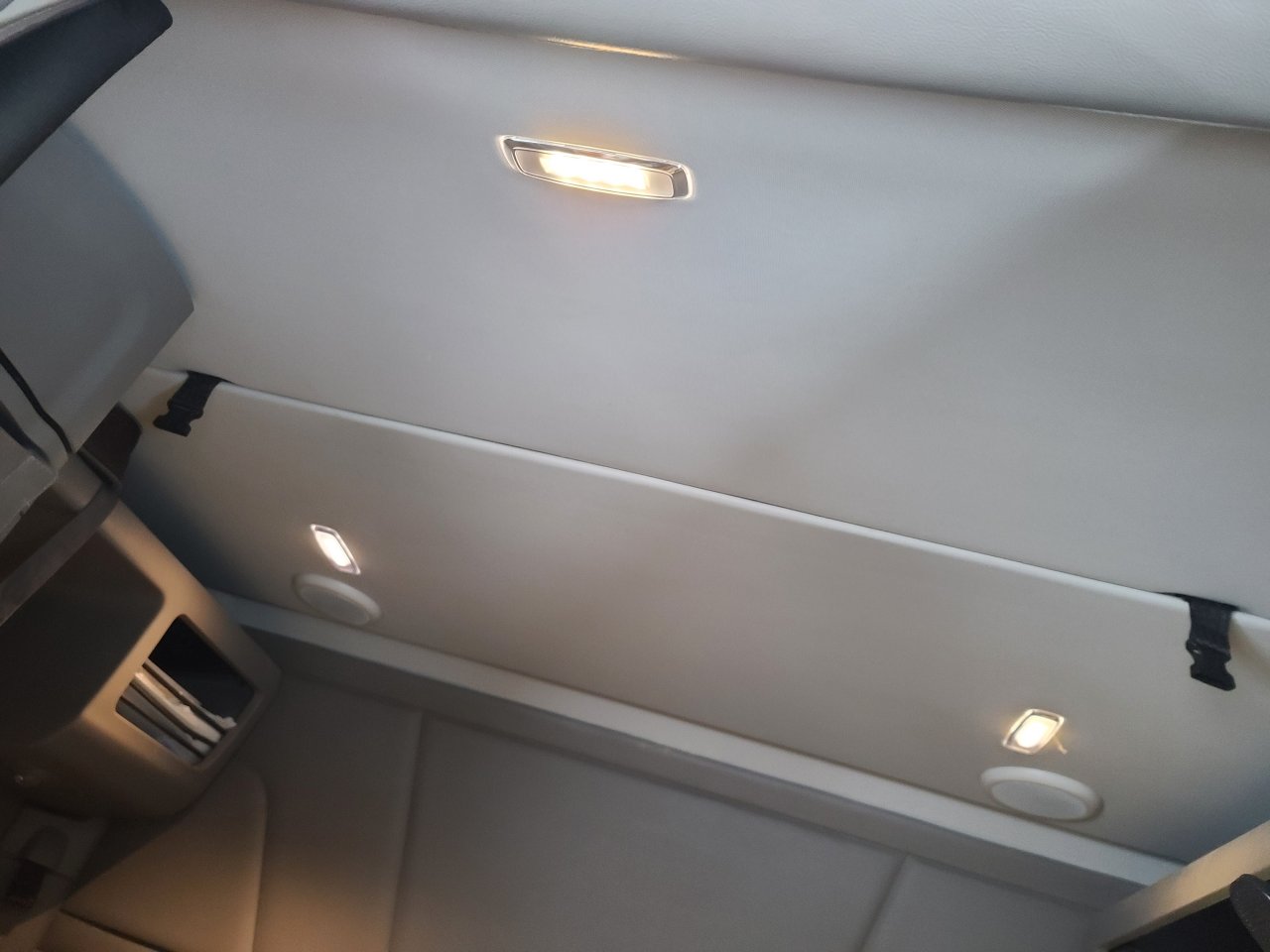

Lost all power to sleeper and interior lights 2017 579.

    Do u have a fuse panel under the bunk? iirc theres a relay and fuse board on drivers side under the bunk that is for the sleeper items. Maybe something got wet in there

    I do and also one under the hood. Checked all 3 and unless its a bad relay im strikeing out x.x

    AH HA! Found it, 2 wires appeared to have rubbed in the frame and were jumping each other. Did some snippy snip and a heat shrink. Seems to work fine now

    And then suddenly not.....well....####

    I see what happened the guy who owned the truck before i did out a 7.5 amp fuse into a 10 amp fuse socket according to my diagram so i popped a 10 in and it works fine for the moment. My guess is that with the wires jumping it lowered the amps just enough that a 7.5 was good enough. Though it also explains why i kept blowing my mirror heater fuse as it was the jumped wire.
