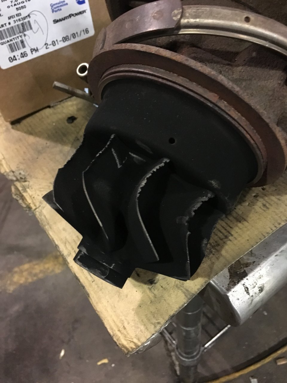

    Hi everyone, thanks a lot for your suggestions, I just fixed it. Problem was in turbo, actually both of them had broken blades. As I told, I just did an overhaul few thousands miles ago, so when my engine stuck, dust and maybe some small pieces of metal gone through manifold directly in my turbos. I'll attach some pictures. 723B2D2F-EBE5-4209-B4AF-00EA15700A35.JPG 12DA0D50-EA7C-430F-8B1C-B10381969F09.JPG

    Did you perform this overhaul yourself or did you have a shop do it? If a shop did are they going to help you replace the turbos? It is very possible that something got sucked in and dusted both turbos. Glad you got it figured out and thanks for coming back on here with a update.

    Shop did all overhaul work, and they not going to help me with replacing. They telling me that probably both turbos was dusted right when I stopped on the highway when my engine down. But I shut off an engine right away after I recognized that something is wrong actually before I stopped. I installed brand new Mahle turbos, 4000$ ($2300+$1700) plus labor.
