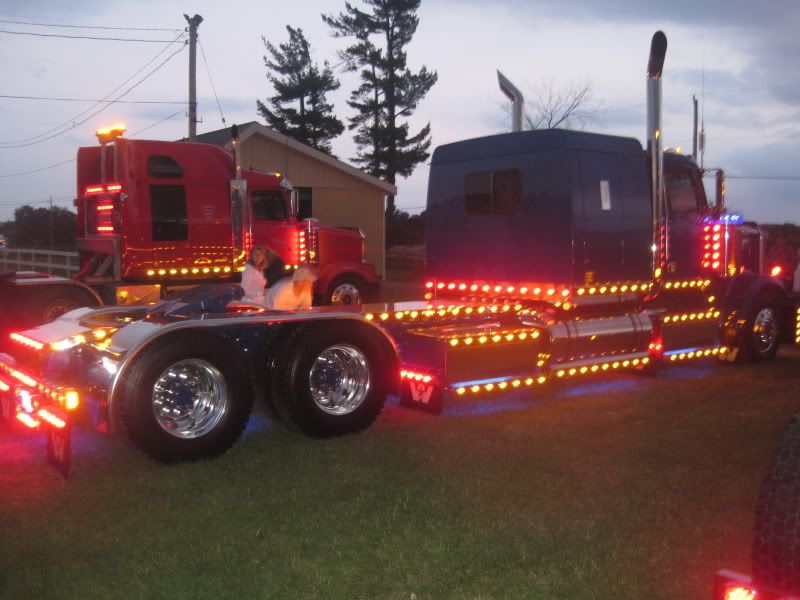

    Trucks an 03. Honestly I didn't even look at it yet. I just know the low voltage light on it is flashing all the time so its gone bad.
    Guys if I didn't know wiring I would have never even attempted this:
    and this
