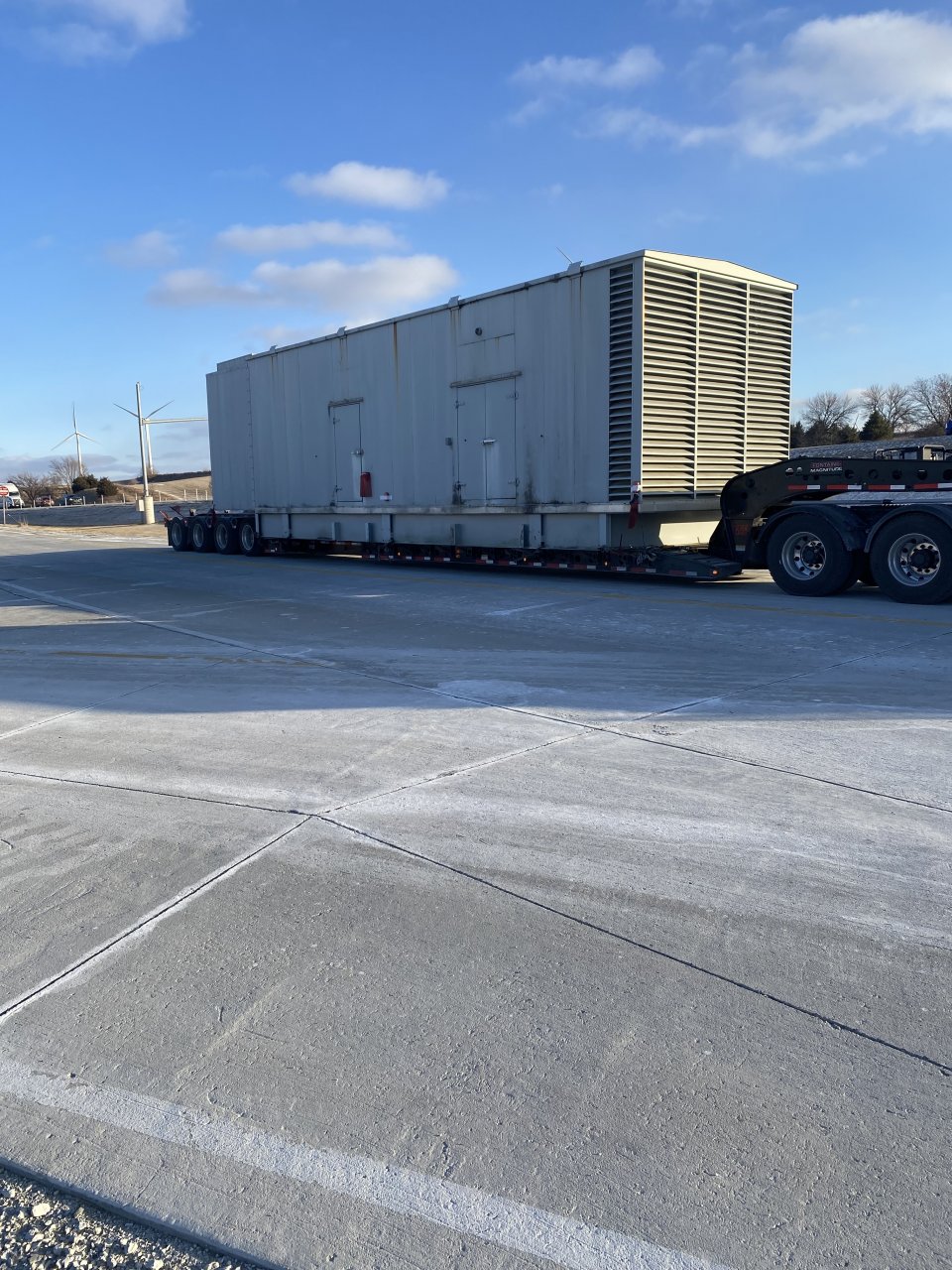

    I can spoil the fun - it approaches $400k before any significant deck inserts. Also, it will weigh north of 40k as a 3 axle - they are supposedly bringing a single booster out to go with it. Plus is deck height of around 12”
    the XL copy is steerable as well but I heard it weighs north of 45K.
    I pulled a Transmaster with 58’ in the well 3 axle steerable and it was very handy but the price will make you go weak in the knees.
    get used to being tall - the XL 40 ton will get you 20” but it has to have weight on it - otherwise plan on 22”
    my MX with no deck shim in will get down to 20” as well
    That is not quite 90k on the deck - I am 21” there
