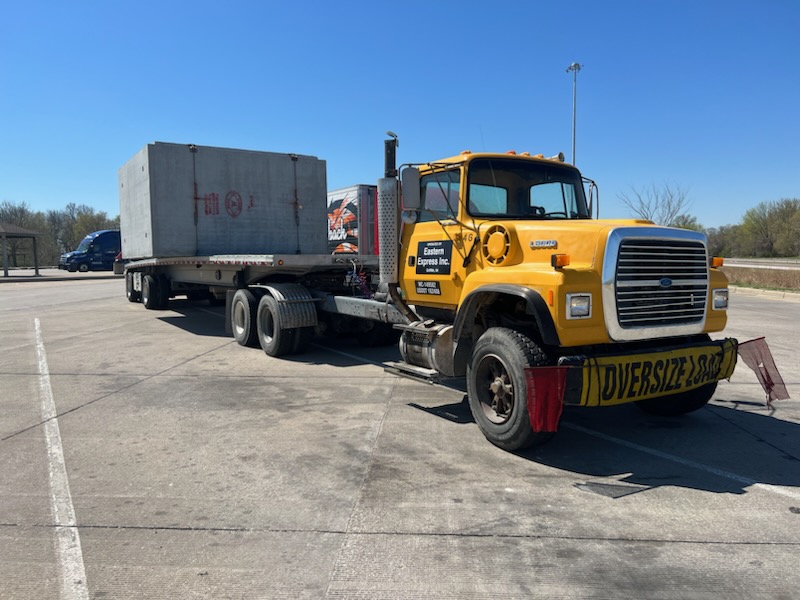

    That’s almost got to be him, should’ve been a mac wagon though #### close on wheel base it’s 252 by the door post. Probably shingles on the deck but idk I pretty much let him do his thing as long as I get my money at the end of the week it’s all good. IMG_1224.jpeg

    That had to be him. I could easily be wrong on the wagon brand, & that Mac looks right. I mean, how many of those Fords are left running the road? Lol
    Was gonna guess Shakopee shingles but I was more focused on the truck.. Heck, I deliver stones to Savage & loaded Shakopee shingles myself.. lol
