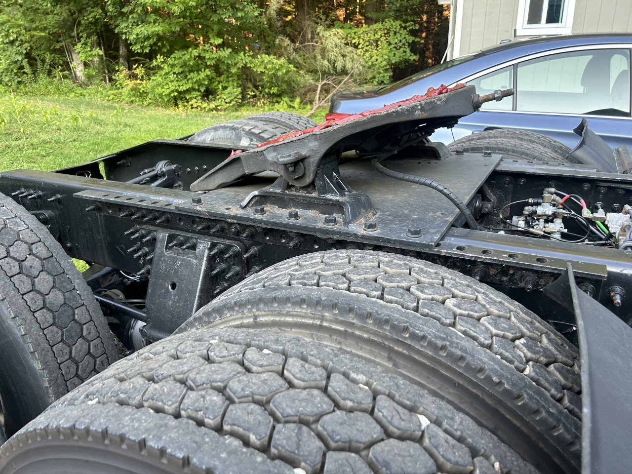

  8. Thetrashnoob
    Thetrashnoob Medium Load Member
    304
    57
    May 30, 2019
    now that I have the truck in front of me…. Looks like it’s relatively easy to adjust, unbolt slide and rebolt. I’m guessing it’ll need to wind up somewhere in between the 2 axles.

  9. Deezl Smoke
    Deezl Smoke Medium Load Member
    563
    372
    Feb 12, 2011
    Hillsboro Oregon
    There we go. Nothing wrong with that.
    Before you adjust it, take a trailer across a local scale. Your wheelbase and front axle position will tell you a lot. There had to be a reason the current position was bolted down in that spot.

  10. 201
    201 Road Train Member
    12,984
    26,772
    Apr 16, 2014
    high plains colorado
    Well, I wouldn't say easy, those bolts will take a lot to loosen. Looks like they wanted more weight on the steer, and that could be a good thing. I wouldn't mess with it, unless you are over on the steer.
  11. Thetrashnoob
    304
    57
    May 30, 2019
    I mean easy in the sense that it can be moved atleast! I’ll have to get a trailer and get it weighed, and hope it’s not over. We run overweight, and right up to pretty much what we are allowed. (Permitted 99k) truck has 12k front and 46 k rears
