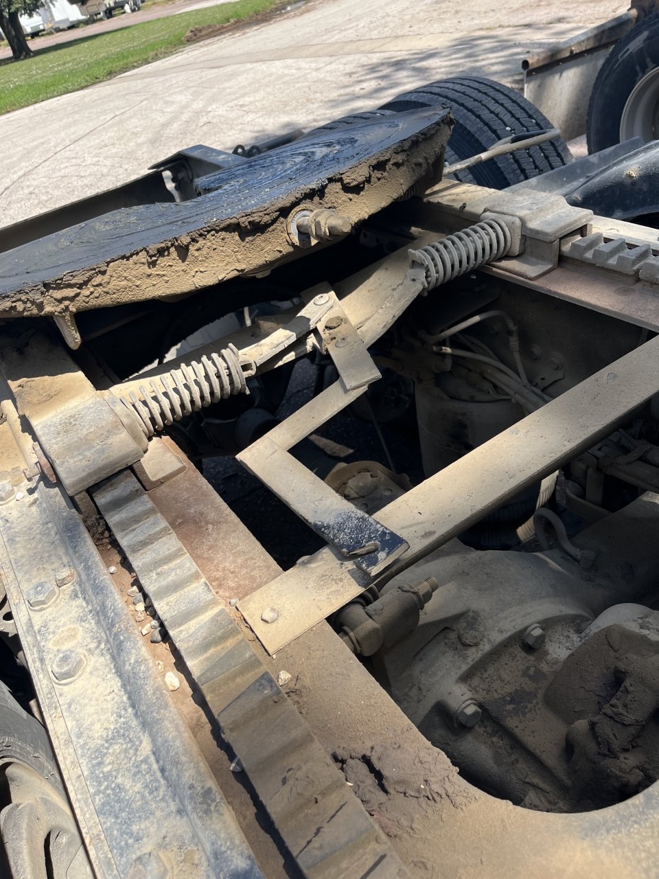

    I’ve never seen a 5th wheel like this before. Have only ever seen air compressed ones. Is this a manual one or is there just something missing ? How do I get this sucker to slide forward ??

    I tried over and over . Will have to try to get someone’s help this weekend . Just never seen a “manual” one before

    It doesn't look like a manual. It looks like it had a air cylinder on it at one time and it was removed.

    That’s what I thought but the truck doesn’t have a filth wheel switch inside of it

    I would wash the dirt and gravel out of the slide area then soak the locks with PB Blaster,tap on the top of the locks with a hammer lightly.Might free it up.

    Did you stop to think that maybe that fifh wheel was on another truck 1st and it was a air release but then put on that truck at some point ? And they had to convert it to a manual slide because the truck was not set up for a air slide fifth wheel ? That's why there's no air release switch in the cab .. ??
    Not every fifth wheel is married to 1 truck forever
    That manual release lever looks like it was a after thought

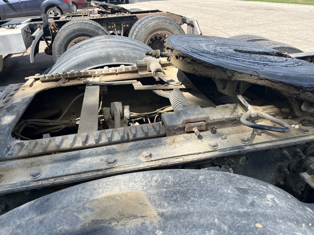

    That is a real manual release. They came with a special rod to use. The notch is there to put a rod with a hook on end to lock it open. Designed that way to make it easier to grab when trailer is on it and in way. There should be a 1”hole or welded on tab somewhere on opposite side for the other end of rod to hold on to.
    Lots of guys don’t know or remember that they were manual long before they had invented release cylinders. Trucks that may move the wheel a handful of times in its lifetime can still have them. Makes more sense when the cylinders just sit and collect dirt or the plastic hose rots and breaks, and they will always leak and not work the one time you do need it.
