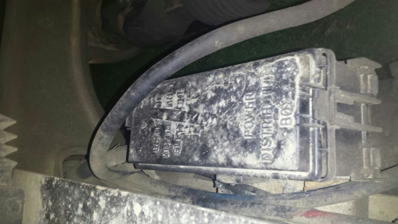

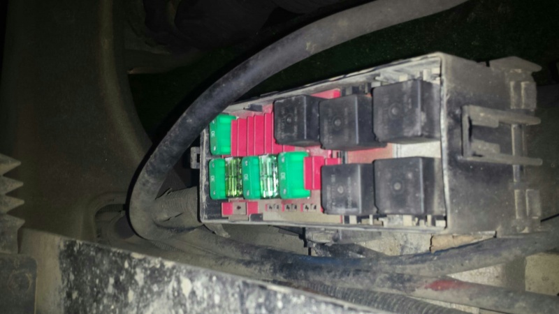

have you unplugged cord from the tractor?
I have a,387. Also. On your frame rail driverside just below cab. Between 5th wheel and cab.
Is your fuse box for trailer. Top of first column is 3 30 amp fuses. As well as on on right side top. I went through 5 fuses to find a wire in trailer rail was grounding out on the trailer. If any are blown. Its a short in trailer wire.
bigNATURE Thanks this. -
thank you for taking and sharing that picture! I will keep that in mind.
