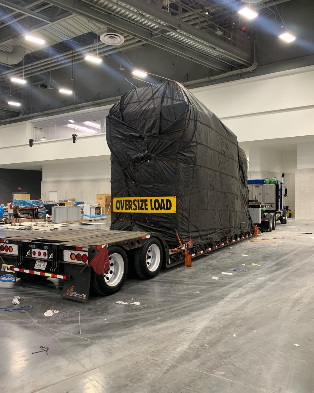

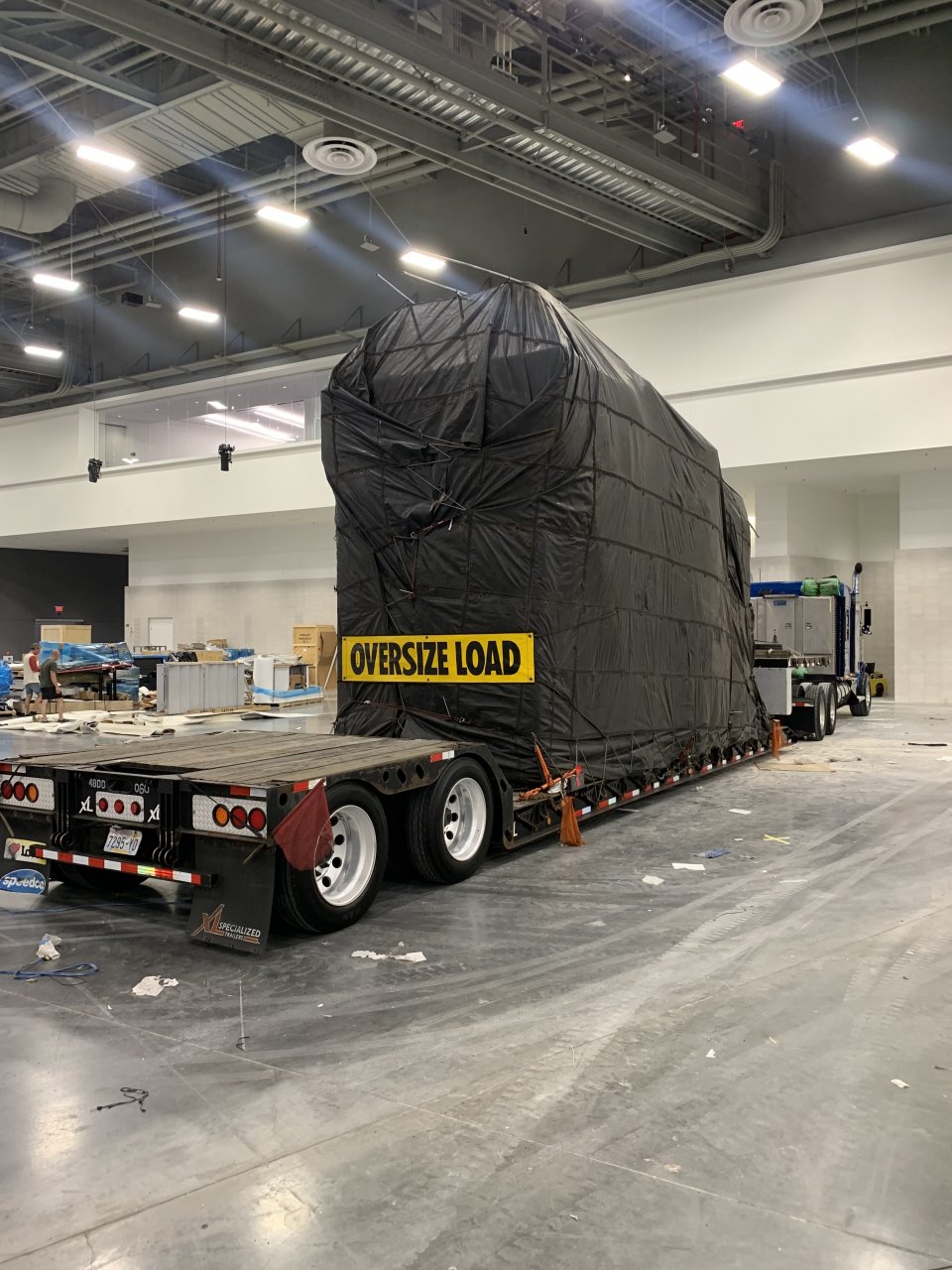

    I consider this trailer to have decent ground clearance at about 8”. I was still popping turtles off the road pulling out of the convention center in Las Vegas. Ironically I sure wish we had a few mini decks for loads like this at 17’ tall. F431C19D-8575-4DEC-AAA8-717C2BC9EF9D.jpeg
