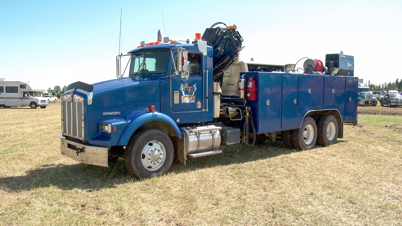

    What about something like this?
    Farmerbob1 Thanks this.
  4. AModelCat
    29,090
    157,556
    This is what I'd love to have but as a high hood. Ultimate rig right there.
  5. pressure_welder
    pressure_welder Bobtail Member
    12
    5
    Nov 3, 2018
    that's almost exactly what I am looking to do, except being that I am a welder I wouldn't have the service rig amount of tool boxes, add a sleeper and you have one hell of a rig !! sexy as hell. and one of a kind really.
