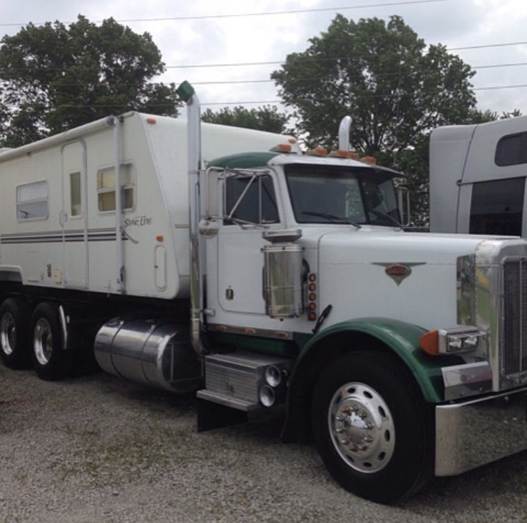

    I have found the answer you need this bad boy right here lmao 2EFF0E2F-B844-48CA-A2A9-8609C6D2B2C4.jpeg
    Farmerbob1 Thanks this.
  4. pressure_welder
    pressure_welder Bobtail Member
    12
    5
    Nov 3, 2018
    haha oh my.... I am sure weather that would get me laughed off the construction site, or put into the looney bin! nice truck though!
