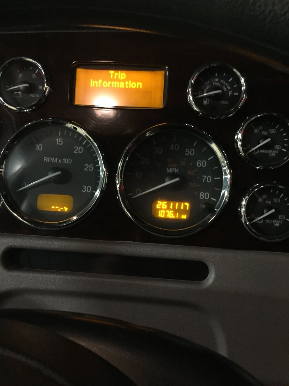

I'm getting Michelin xdn2's
put on today, the 710s made it to 261k

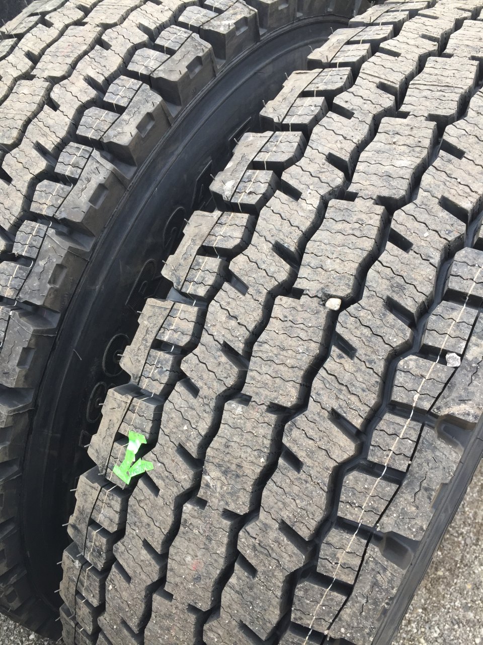

How'd you get a picture of my tires lol ! What is the rolling resistance or the xdn2 or don't you give that much credence ?Road Killer Thanks this.
his fuel mileage is gonna go to #### hard. not only are the rolling resistance crap on the xdn2, compared to the 710....... and more so, compared to a very worn 710, it's gonna blow his mind just how bad it'll be!!!
I went from a worn Dunlop 431a to bridgestone m799 and I'm kicking myself for my poor life choices. $50 a day more fuel easily!!Road Killer Thanks this. -
