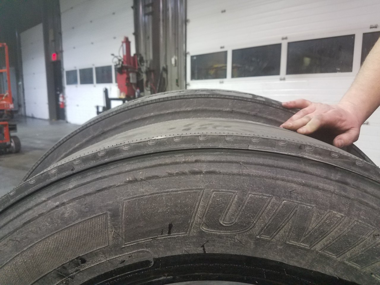

  4. albloomfield
    albloomfield Bobtail Member
    21
    20
    Oct 12, 2018
    I got to loves, took the tires off, they had on an 11R 22.5. Not the 295/75 they told me they put on over the phone today.
    The tech at loves said they never should of put that tire on.
    Do I have any recourse with Petro?
    KB3MMX Thanks this.

  6. albloomfield
    21
    20
    Oct 12, 2018
  7. albloomfield
    21
    20
    Oct 12, 2018
    The bald tire was put on 1-4-2019. It was brand new.
    tucker Thanks this.
  8. adayrider
    adayrider Road Train Member
    1,289
    1,732
    May 7, 2018
    Looks like driver error as much as the guy that put it on. Safe to say you paid the bill and drove without looking at it. Absolutely no way you could not have seen this if you would have looked.

  9. albloomfield
    21
    20
    Oct 12, 2018
    It was an inside tire. I tried to read what they put on yesterday, but you can't read the tire make when it's the inside tire. I talked to the loves tire tech and he said it's not DOT legal to put an R11 22.5 next to a 275/80 22.5. These guys are supposed to be experts. We're not allowed in the shop to watch them do the job. Shouldn't there be some sort of expectation that these guys know what the #### they are doing?

  11. Samarquis
    Samarquis Light Load Member
    227
    549
    Dec 20, 2017
    Maine
    So... Your concern puzzles me. The 275 was put on last week? And since that point Petro put on the 11r22.5? Clearly you have mismatched tires but I'm not seeing how your timeline and descriptions make sense.
    Also as stated above, you really should have looked before you left. The argument that you can't read the size on the inside tire is INVALID. It's not that hard to crouch under and look at the back side.
    The tire shop definitely appears to have failed you. But they aren't the only ones
