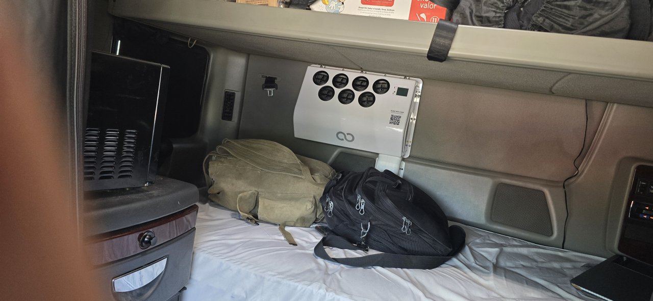

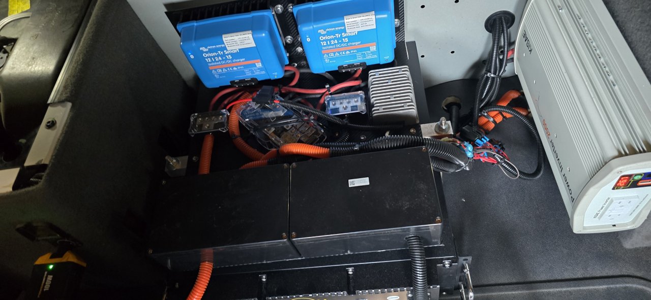

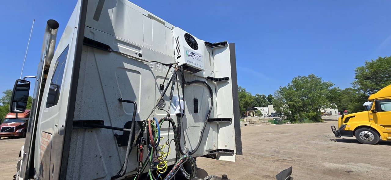

  9. Arctic_fox
    4,023
    20,943
    Sep 16, 2016
    Lol ask and ye shall recieve. Like i said though i only have half the system so until i have the whole thing i am reserveing final judgment. But just batterys....i am not impressed. The whole point of an APU is less idleing. Not as much or more. And if the solar means i only run need to run a genny in extreme heat or a couple of hours of idle that is acceptable. But im going from 100% to 0% in like i said 6 hours MAX ive been averageing around 4 and a half to 5 since 76 is too hot to sleep well even with a fan though i can relax in it and be alright. 72 is about the max i can tolerate for good sleep and 70ish is my ideal.

  11. Tb0n3
    Tb0n3 Road Train Member
    4,524
    8,865
    Oct 5, 2012
    Earth
    If you've only got 30 amps of battery charging off your alternator that would explain long charge times. My LT with epu spec the alternator like 360 amps. They make bigger DC-DC converters. I've got a 50 for my boat. I guess if you're boosting to 24 it's 60 at 12V, but still anemic.
