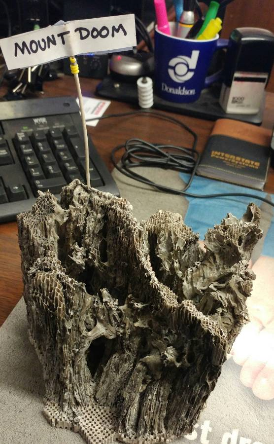

    can you recognize this part? :)
    Melted core of DD15 DPF. how this happened? The driver let engine idling at night. it was cold out there. :-( Some of fuel did not burn completely (this calls fuel absorbent) and sit there in DPF. When he started driving overheating happened in 1 box because of burning fuel and melted the core. This story I read at DTNA tech talk. So to avoid this situation your truck must be programmed. The feature called ' Auto Elevation' must be enabled in MCM/CPC. the feature rises idling speed of engine to burn absorbed fuel in 1 Box when needed. Trucks come from factory 'Auto Elevate' disabled.
