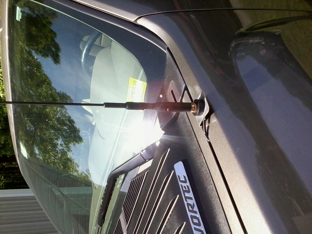

    My type n mount design consisted of these 2 parts combined.
    Totally watertight

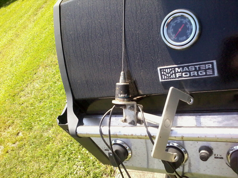

    Here are pictures of the assembled NMO mounts. I ordered the mounts including cable assembly so I knew they would be compatible. Since N connectors are standard for 440 MHz base antennas I would surmise the SO 239/PL259 combination for CB and HF antennas is a cost saving for manufacturers. 160611_002.jpg 160611_001.jpg

    Here's a creative mounting idea using a piece of sheet metal bent at a 90-degree angle.
    Would work for NMO mounts
