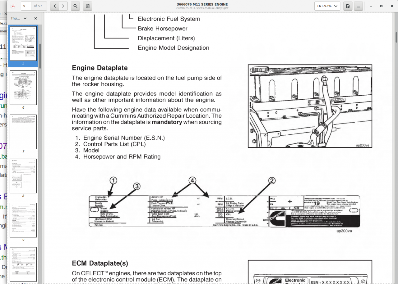

    where do I find the CPL?
  7. frito bandito
    frito bandito Light Load Member
    124
    457
    May 31, 2019
    On the engine data plate.
