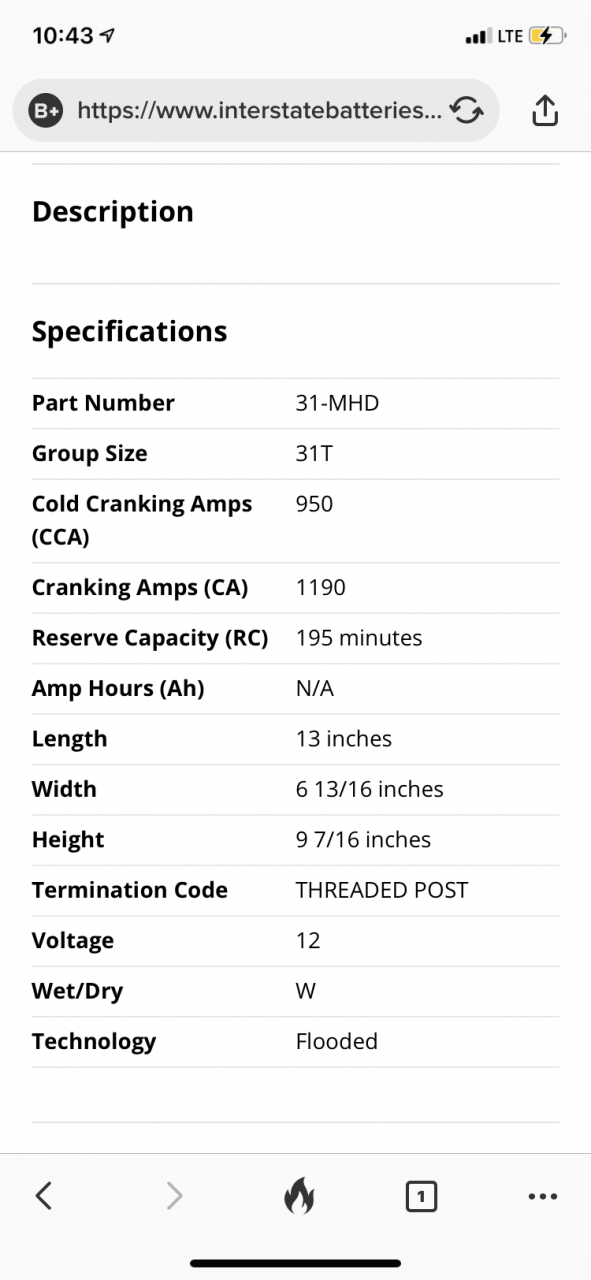

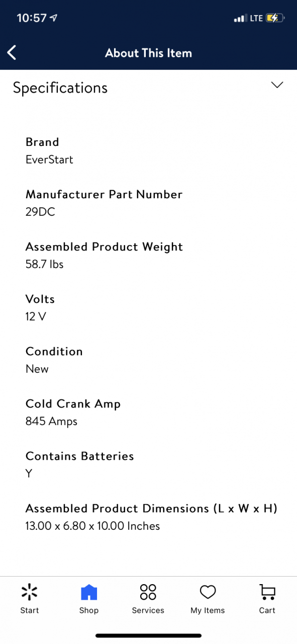

    So i bought 4 interstate cca flooded batteries. My truck has an apu so I got 4 deep cycle marine batteries rated at 800 cca.
    Didn’t know that it was all one system and all the batteries are connected.
    I can’t return the deep cycle since returning period expired.
    Will truck run fine or will I kill the batteries?

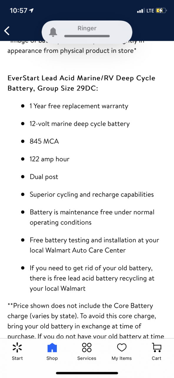

    Well they called marine batteries but they are just deepcycle with high CCA. Good for boats or RV. I figured they will run APU. But didn’t know all 8 batteries were connected.

    Place an isolator in between deep cycle and truck batteries, or at very least a low voltage cutout if it doesnt have it, deep cycle is prefered on hotel loads. Not doing any real harm unless deep cycles never get fully charged
