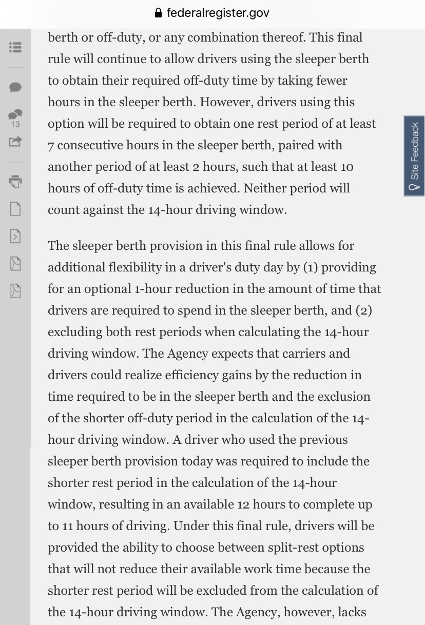

    Do you have proof of this? If you log off duty for 6, yes the first 3 count, but pretty sure the last 3 count towards your 14.

    Neither rest period counts against your 14. And it doesn’t say you can only have 10 hours total, just that 10 hours total is the minimum.

    As @Long FLD said, according to the new rules neither break counts towards the 14 and that the shorter break must be AT LEAST 2 hours, and the longer break AT LEAST 7 hours totalling AT LEAST 10 hours when added together.
    This was something I was very interested in so I have read everything I could find on it. Then last week I had a conference call with my company compliance guy and a gentleman from the FMCSA to confirm that my understanding was correct.
    I asked this FMCSA guy very specifically about a break using a break longer than 3 hours but shorter than 7 hours as part of the split berth reset. He confirmed that only 3 hours of it counts toward the split reset, but that indeed the entire length of the break was excluded from the 14.

    @Cattleman84
    I too was intensely interested in this change. It appeared to solve my biggest problem with the 14 hour clock.
    My common practice is to start the 14 hour clock, at about hour 7 or so stop for the all important nap( or bicycle ride or whatever). If I do that for 3 hours, then be allowed to extend the 14 hour clock to 17 hours. Then take the usual 10 off and it appears I am totally legal to begin the next day with 11/14. Is that correct?

    From everything I have found reguarding this rule you would be perfectly legal to do as you stated, PROVIDED that at least 7 hours of your normal 10 off is logged as sleeper. If you logged your entire 10 hours off as Off Duty, then the break mid day would count toward your 14 hour clock.
