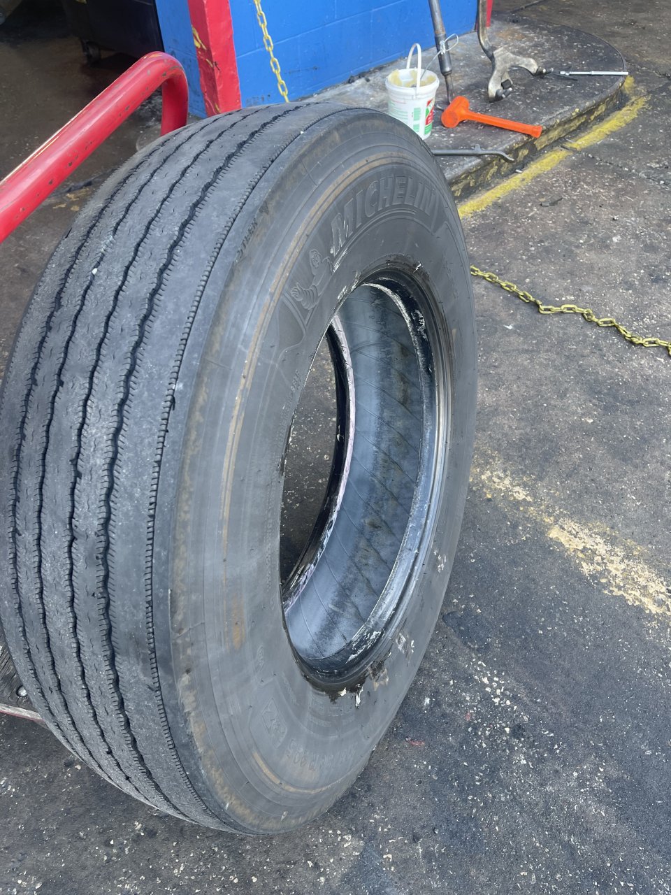

    that is pretty good. what psi have you been running? I only have 86k on new ones so far and looking good. running it at 105 so far.

    That is a very lightweight steer weight. Not a very big motor.

    They showed cracking and age i just wanted to be ready for this summer

    I ran 105psi driver.

    That is what I have bene running mine/ Hopefully I will get something close. Thanks

    I remember hoping to get 100k from a set. That was considered normal. Not much has changed. Running higher speeds now. Roads aren’t any better. It’s got to be the Tire Technology. Amazing.

    Impressive! Last set was 193k. I usually ruin them before getting that high though.

    On my 379 the shoulders always wear down fast and I get maybe 80k miles. New bushings, new king pins, new everything, centramatics, fresh alignment, new shocks. I was told to do a closed shoulder steer and will try it next time. I usually do Bridgestone 284 or Firestone 591.
    On my T680 I change every year and the tire still looks new. I save it for trailer tire.
