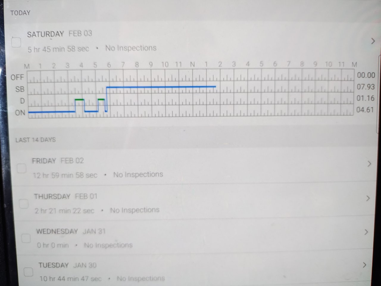

    IMG_20240203_134240700.jpg IMG_20240203_134230475.jpg Hey y'all. I'm using Motive, and I have never tried to use the split sleeper rule before.
    I used up every bit of my previous 14, then went into the sleeper just under 8 hours ago. When I click the "Show Split Clocks" switch to on, it still shows me with no hours available anywhere except my 70.
    Is this because I used up my entire previous 14 and haven't had 10 hours SB or OFF since then?
    If I had gone into the sleeper before my 14 was up, would it be showing me with available hours right now?
    Thanks in advance.

    I’m not familiar with oilfield rules, but basically if you used your entire 14 there’s nothing to split. You’d have to have time left on your 11/14 to be able to split.
  6. RockinChair
    RockinChair Road Train Member
    5,408
    14,576
    Feb 19, 2012
    Lubbock, TX & thereabouts
    That's what I suspected. Thank you.
