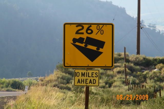

    COOL!!!!!!!!

    OH GEEZE LOUISE! That's UP hill too from this direction! :biggrin_25524:

    I live about 60 west of this and yes its that steep, and several sharp switchbacks. Its no joke fokes. Used to haul cattle from the valley near Stockton and go over loaded on SR 88. Once unloaded we would come home MT over Sonora Pass. Back then we were in truck and trailers that were good for mountion rds. One wouldnt even think about crossing Sonora Pass with a semi or doubles. And ya darn sure better have twin screws to get you through those steep sharp switchbacks.

    Well you wont go down this mountion loaded 1 time driver. You wont be able to go slow downhill, because you have to get to the top first
