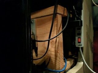

    I used a tv wall mount. Got one that extends out. Made sure to get one that extends at least more than half the width of the tv. This is so that the mount can be on the side of a cabinet and not on the side of the truck, aka where your feet would be. The tv can then face perpendicular to the mount, which is the direction most people want it. The plastic on the cabinets is thin, so the leg bolts the tv mount came with screw into a large piece of wood placed on the opposite side of the plastic cabinet. Holds nice and solid. The tv mount came with a large square bracket that screws on the back of the tv. This mounts on the swivel part easily and a "safety screw" secures it. I don't use the "safety screw" as i ike to take the tv on and off as needed. The trucks shakes so much I feel better putting the tv back into it's box before travel. Takes the stress off the mount as the extended mount like mine would have considerable leverage if the tv was left on and the truck shakes all to hell. This setup works great for me and the tv can be moved into many positions easily. Easily put up, and then easily stored away. I think it's just a 24". Don't need much in a truck. All this was done with a Freightliner Cascadia. I'd post some pictures, but I'm home and the truck is at the yard right now.

    Here are pictures of my setup. I remove the TV and place it in its box when the truck moves. 2013 Cascadia. Company truck. I doubt anyone would notice the two holes. Or care. Hard enough to get Ryder to fix things that matter. IMAG0082.jpg IMAG0080.jpg IMAG0079.jpg

    That's a good move taking it down when the truck moves. I have a Vizio similar to yours. It was mounted to a similar mount that came factory installed in my Prostar company truck. I kept the TV permanently mounted there. Regular dedicated runs across I-70 in Indiana and other POS roads shook it to the point that the back case of the TV cracked and broke away where the mounting screws attached. I took it down a few weeks ago when it was hanging face down with the electronic circuit boards showing.
    Still works though. I plan to turn it into a red neck portable media center by wrapping it in 2X4s and plywood for use at tailgates during football season.
