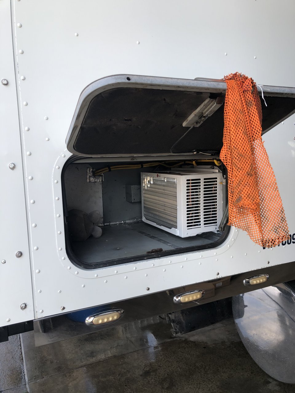

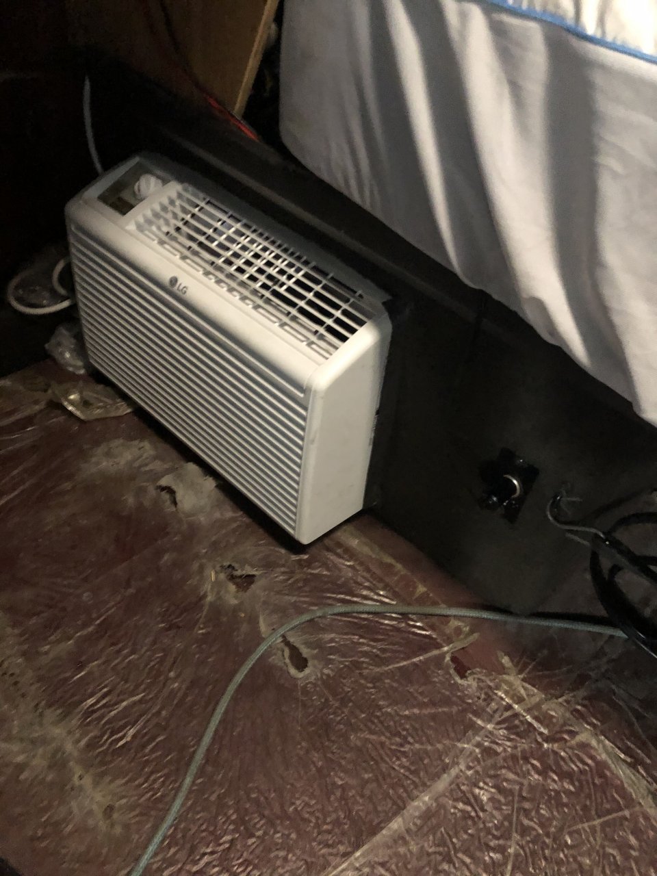

    No i changed over to this system a couple years ago. This little generator will run this little ac unit for 10 hours on 1 gallon of gas. The other system was 3 gallons a night and 2x the weight. This ac unit works better than the stand up unit too. Very quit too. 796194D3-6E9C-437D-A351-B41CCF65CD85.jpeg 3D2A0384-1102-40C1-BF4B-16336EBD3ABC.jpeg I have since added baffling and a 12v fan to increase the efficiency of the ac unit.
