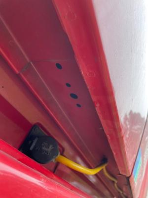

    I guarantee if you park next to my Volvo with the exhaust pointed at it on a night where the air still, you'll set off my CO detector. I don't know why these holes are there, but they run all along the outside edge of the cab and lead directly to the interior.
    The first generator I had on here was a little Ryobi. The very first night I ran it, I scooted it out to the edge of the catwalk, exhaust pointed away and went to bed. I woke up a little earlier than I wanted because the CO alarm was beeping and saying, "Warning! Carbon Monoxide!"
    Even someone else running a generator from a couple trucks away will cause mine to have a reading--I check it every morning.
    Please be kind to your neighbors and hook up an exhaust stack.

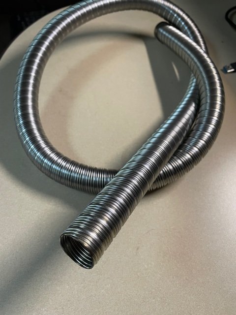

    It would be easy to run some 3/4" conduit alongside your exhaust stack, @harold6091. The stack doesn't go up and down with the cab.
    This Espar heater pipe will fit the exhaust stub on the muffler of that Predator perfectly if you remove the spark arrestor. Be sure to reinstall the two bolts so you don't have leaks. Cut a little of the plastic around where the pipe sticks out so you can get a small ratchet in there to hose clamp it to the pipe. Permatex Ultra Copper makes a good seal.
    The Espar stuff is $75 a box but I cut it in half and get one year out of each piece before it needs replaced.
