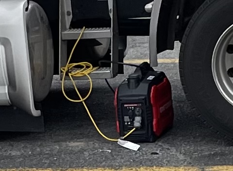

    I'm still looking at different ways to set this up but what if I ran the exhaust just to the end of the frame on the tractor?
    Is that far enough away to not cause anyone a problem?

    Any gasoline engine exhaust that's at ground level can be a problem especially if the air is still. I was three trucks away from a guy running one under his hood and it caused a high enough reading on my detector to almost set it off.
    I'd do what it takes to get it up in the air.

    May simply consider a 12v radiator fan angled to hit the generator and exhaust to disperse. Will depend on mount and generator exhaust location as well as how much the fan pulls, but worth a thought.
    Bonus points, itll keep generator a little cooler especially if semi-enclosed

    If you drive for Landstar and this is your truck, don't do this.

    use the venturi effect by running the generator exhaust up from the elbow at least 8 inches inside the pipe. That will cause a slight negative pressure in the generator exhaust system when the truck engine is running.
    This can also be used with a pipe into the bottom of a vertical muffler.
