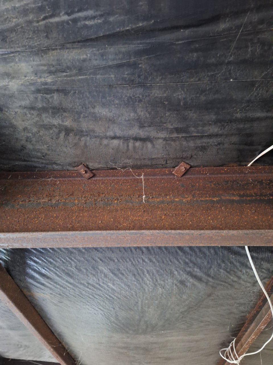

    With or without the OSB you can run lag bolts from the under belly up in to the floor joists. There has to be fasteners holding the OSB to the joists. Put the lag bolts in the same line where those fasteners are, that should be the joists.
    Take the picture I drew. That is the view underneath the house looking up. Use lag bolts not straight bolts.
    I used a straight bolt because I don't have a lag bolt, just to show washers.

    Picture is from my basement looking at underbelly of house.
    This is how the factory fastens house to frame. Washer can be any size or shape random thickness. Doesn't really matter as long as it holds.

    I think I will have one of the guys punch out some washers from 1/4x2 flat steel and do something like that
