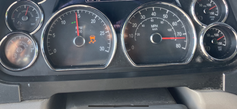

    Those RPMs are kind of low. It’s true that lower RPMs will give you higher MPGs, but if the terrain has a bunch of hills, you’ll end up downshifting many times, lowering your MPGs.
    Unfortunately your truck is spec’d to run 1100-1150 at 62 mph. I believe that can be changed if they plug in the computer. My truck gives me 1300 rpm at 62 mph. I can get higher MPGs if I lower my rpm, but then I’ll be driving at 55, which I don’t do.
  5. PE_T
    PE_T Road Train Member
    I think you’re misunderstanding 1100-1150. The picture you posted shows an rpm of 1400-1500.
    By the way, that green light on the dash is probably the recommended rpm. I drove a 2016 Kenworth T680, and I remember it having the light as well.

    The picture is also showing 73 or so, the OP said he’s 1100 at 62.
    Doealex and PE_T Thank this.
