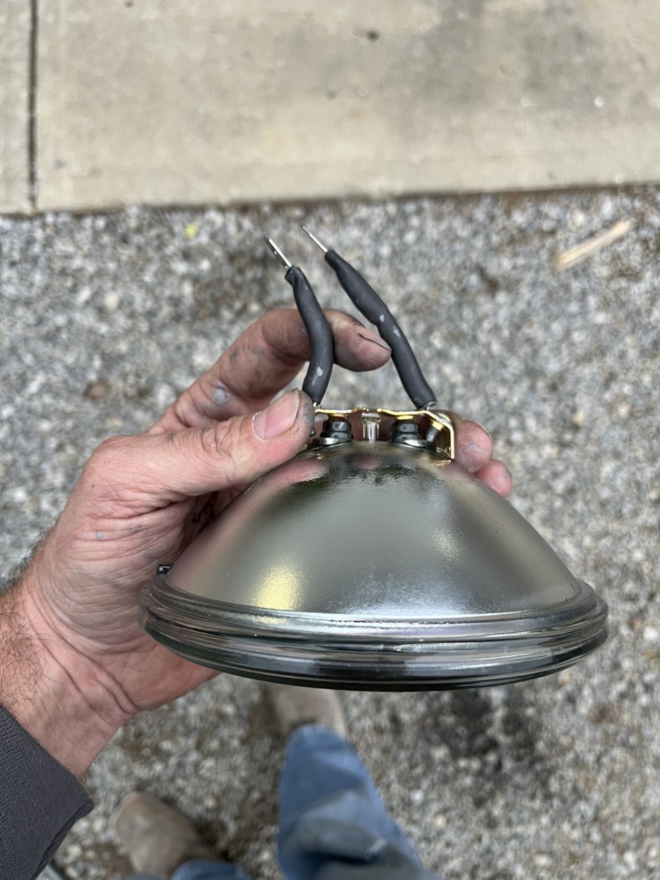

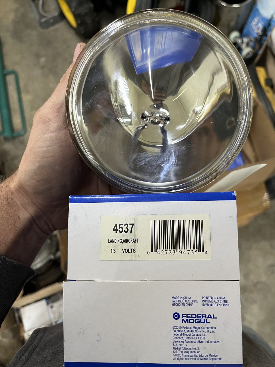

    While we’re fixin’ stuff, this was my project for this evening. These went in ole Turtle for high beams.
    Typical high beam is 50-60 watts, these are 100 watts.
    Period correct, and a whale of a lot cheaper than LED’s.
    We’ll see what I think of them when I head out Monday morning.

    Probably something you already know but check your grounds take a meter and check the amp draw at the plug. Bad connections is what makes the wires behind the switch feel warm to the touch. Sometimes it’s corroding in side the insulation that causes it and you never see it. I’m not saying those won’t help but they could add to the problem by drawing more amps and creating more heat. A lot of the reason older halogen lights seem not so good is todays lights are so much better I agree. I also think we seen better in our 20’s. But I do think a lot of it it pressure and time on an older power unit. I sold an 86 while back that had those for high beams the difference was night and day after we got the fire in the wire

    I've used them back in the day, they get hot. Don't sit around with them on , need air flow to keep cool. Adjusted properly you'll be able to see the future on a dark night.
