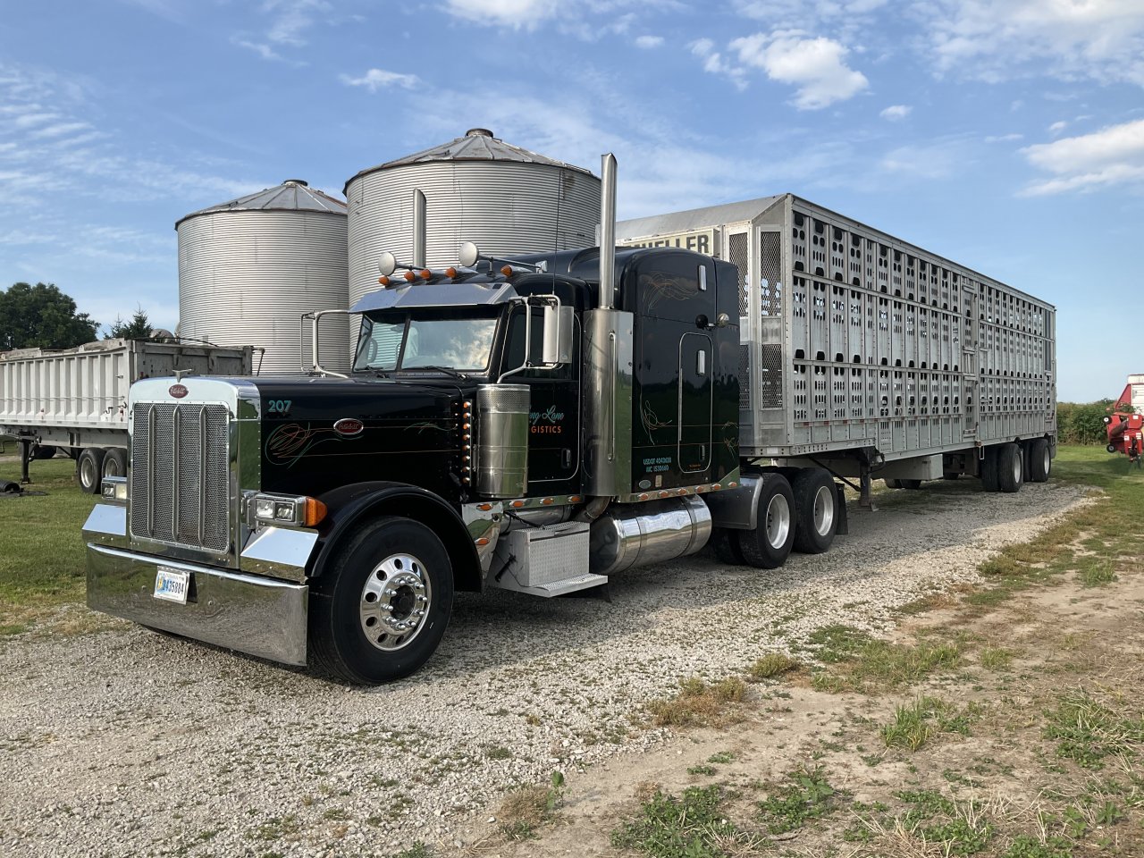

    That’s a good lookin unit for sure

    Lookin large and in charge!
