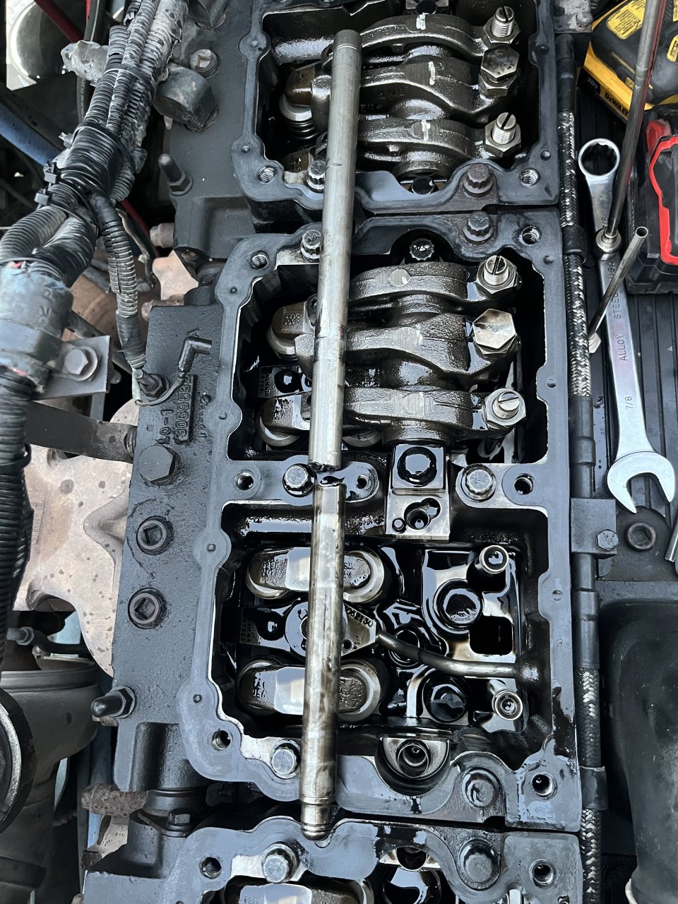

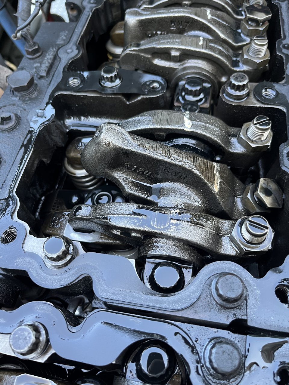

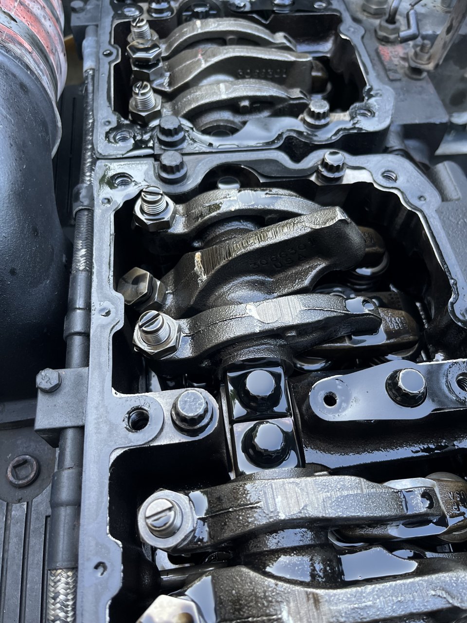

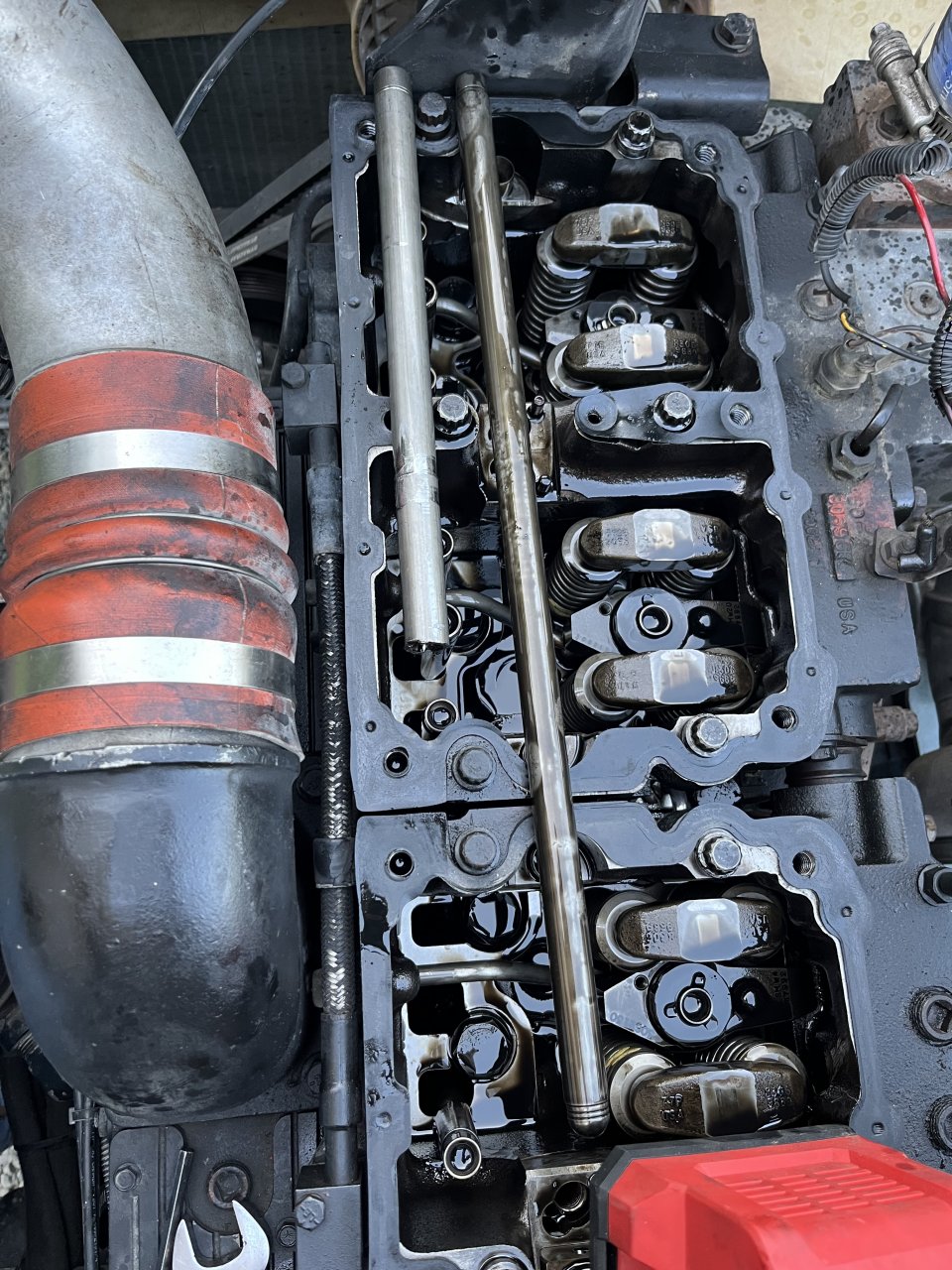

    Well, I finally got a chance to tear into my heap…
    I have said since this started the noise was coming from #3… IMG_1224.jpeg IMG_1223.jpeg When I get the Jake housing off of 3-4, this is what I see. IMG_1225.jpeg Then this. IMG_1228.jpeg
    Thankfully I was able to fish the lower piece out.
    It was out of the socket on the cam follower, sitting down in there at an angle.
    Thank God it hadn’t jammed…and got spit out the side of the block.
    I don’t think it is any coincidence that when I ran the overhead after the other shop had run it twice, #3 injector was WAY too tight. It took over 140 inch lbs to loosen the adjuster, and it should have taken 90-95 inch lbs.
