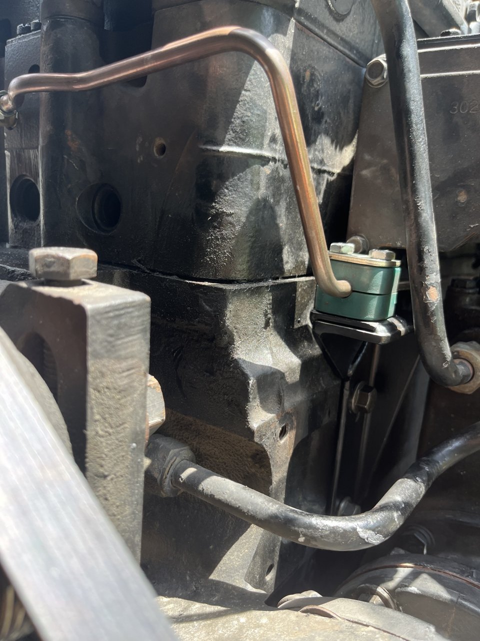

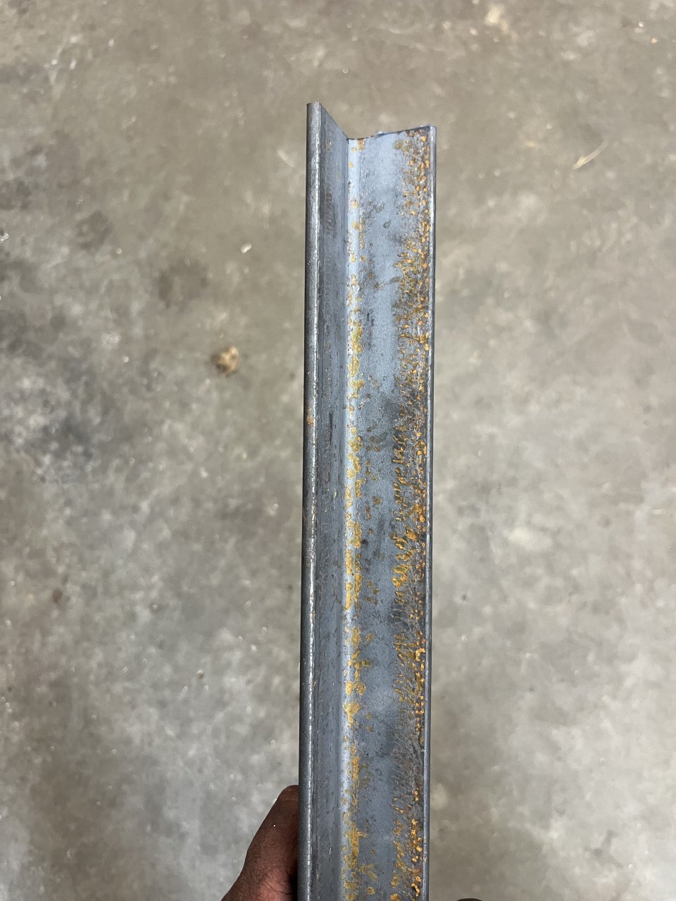

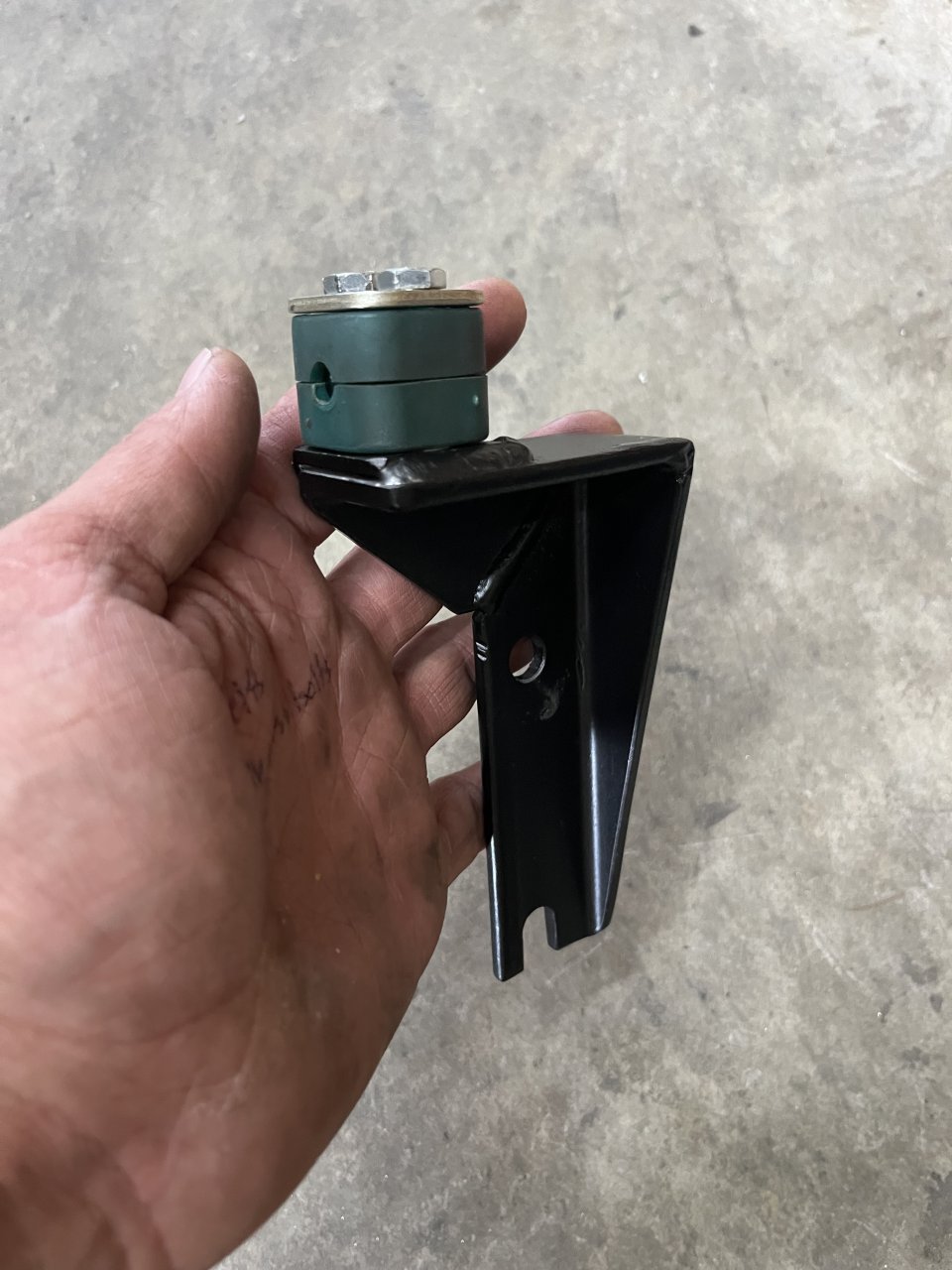

    To this.
    Support for the fuel line that goes to the front of the head.
    This mechanical N-14 only had a single fuel line feeding into the rear head.
    I got a Pittsburgh Power dual fuel line kit, and 6 months in the pump end of the front line cracked at the flare. Modified it, and 2 months later the head end cracked at the flare.
    Pittsburgh says, “Oh, it is supposed to be supported.”
    Nice to know, but nothing was included in the original kit to support it.
    Buy a new line (no warranty on the original one), but it’s the wrong line.
    Finally get the correct line, and this is my solution to support it.

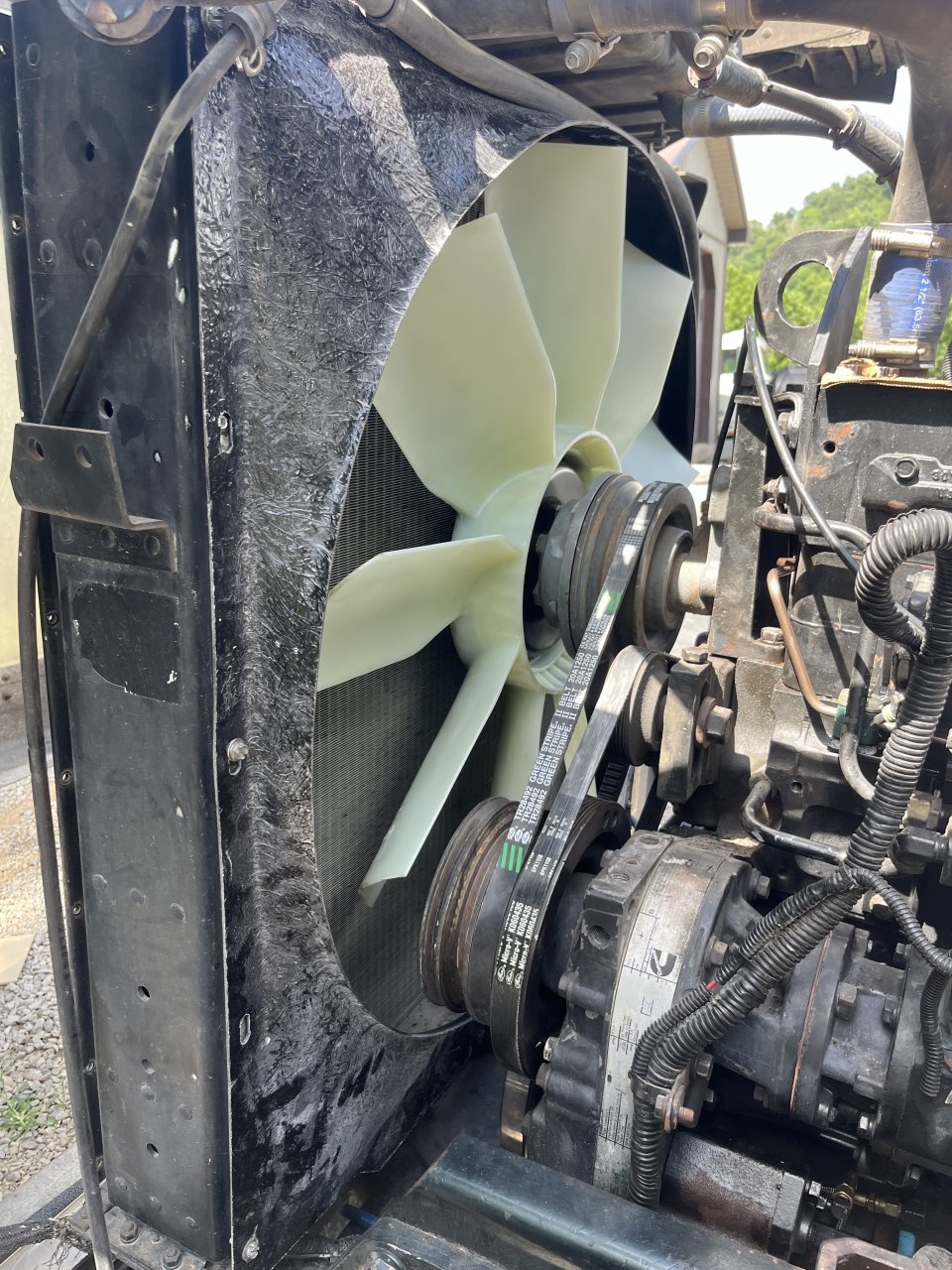

    IMG_1331.jpeg Fuel line, fuel line bracket, fan hub assembly, belts, fan (9 blade versus the old cracked up 6 blade) and new fan shroud back on.
    We’ll keep pecking away at it in the evening next week.
    Don’t worry, all the bolts will get put in on the fan shroud, but the missing ones are for the a/c line clamps.

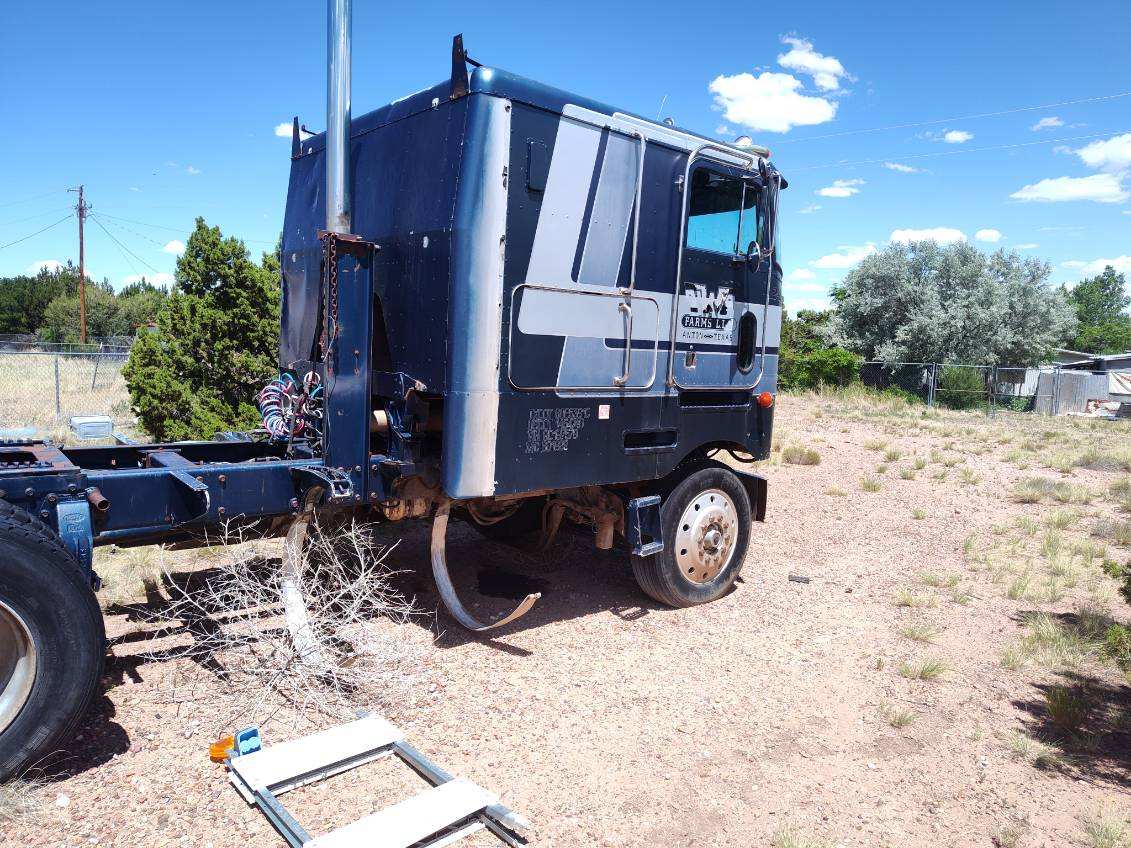

    That is a cool looking cabover! You should buy it and get it back on the road Deere Hunter.
    cke, Feedman, High Stepper and 7 others Thank this.
  11. Deere hunter
    1,946
    8,454
    Aug 5, 2017
    Shallowater Texas
    I actually still own it. It's a long story ha ha. It's got a good B model in it with a 14613 double over. And 3.70 rears
