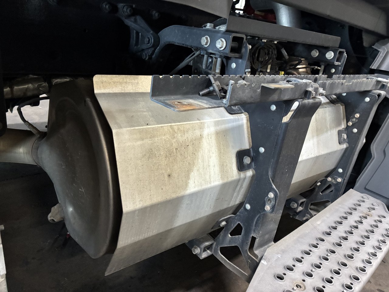

    No I’m just R&R taking it to Little Rock to get cleaned. Its not giving trouble customer just wants try and do preventative maintenance. This better not blow up in my face. I hate working on stuff that’s fine, cause usually it ain’t no more after I #### with it
