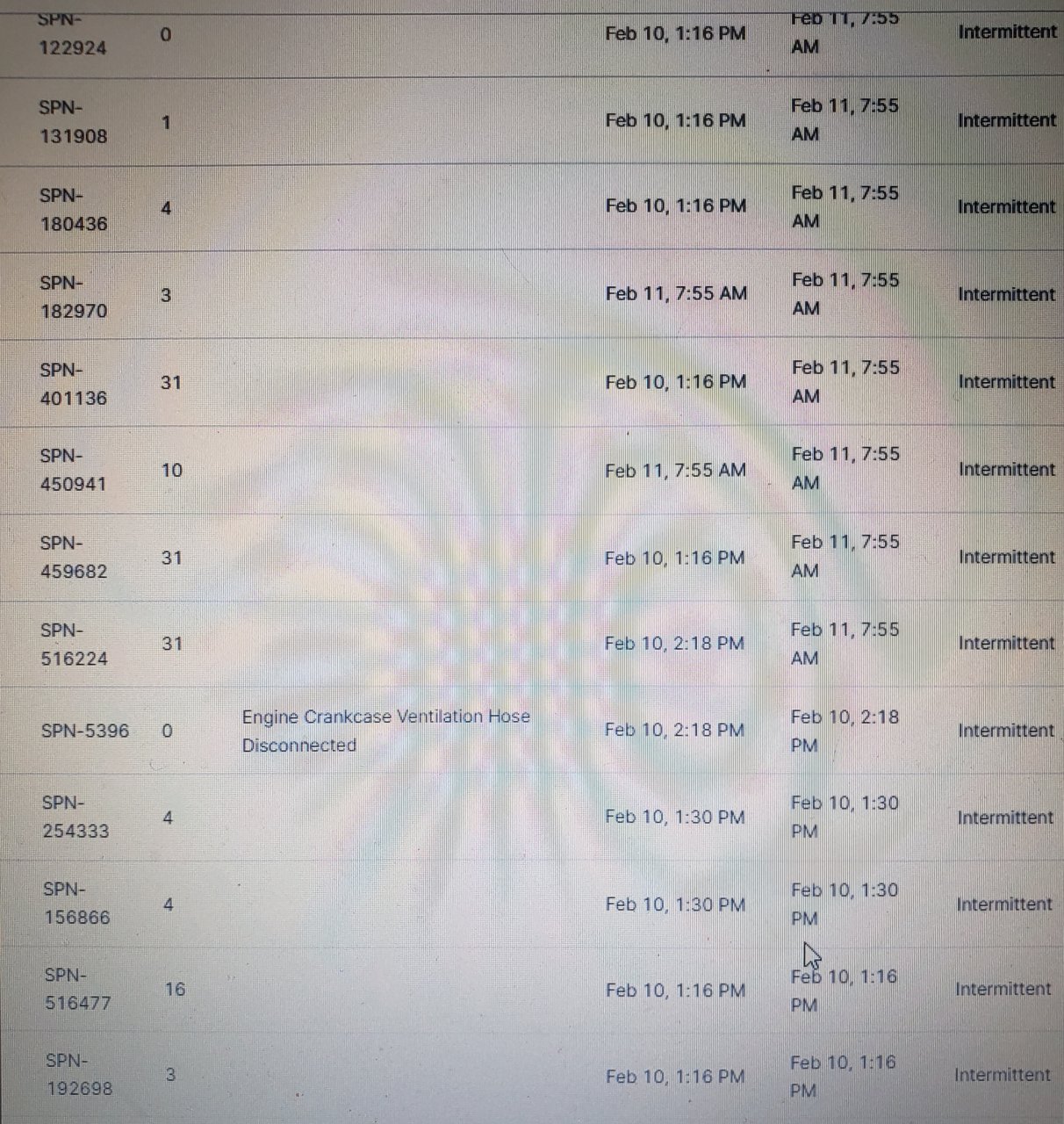

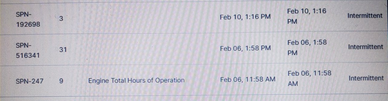

    What do you think about this ;
    After changing to new ocv and fuel doser injector, I get all these codes .
    I paid KW to do a Regen and they did not but instead told me to bring truck in so they could figure this out. I won't let them work on it.
    I pulled these codes with my eld. Same codes kw pulled.
    Edit :
    I just noticed the upper hose disconnected from ocv. May have broken .
    Would that cause any of these codes to appear ?

    You have alot going on here.
    First off, Troubleshooting from ELD is not reliable. But I will give you what I can interpret from what you shared the best I can>
    First, your Fuel doser fault is electrical in nature and not a plugged or flow condition. If the fault is still occurring, you likely have a wiring issue from the EAS to the doser since the doser has already been replaced.
    As for the CCV module you have the correct updated part and it now contains a serviceable filter. I would start with checking all fuses- With no rotor speed it is possible the old module blew the fuse. If the fuse is good, check power and ground at the CCV module if you still have no rotor speed after run time.
    It appears you are also have a bad outlet NOX sensor. Faults are indicating biased or internal sensor error.
    To get more- I really need codes as logged in Davie and fault status of active or Inactive.
    Good Luck

    Where do I find the fuse for the ocv ?
    KW did not print me off their codes. Just showed them to me.
    Also engine running good. I drive it 65mph 100 miles to kw and 100 home. Did not use any oil that I could tell.

    I hate to guess with no chassis info.
    579/T680 fuse location is in the under hood fuse box. Check all engine fuses. It will not be labeled CCV. Just check them all.
