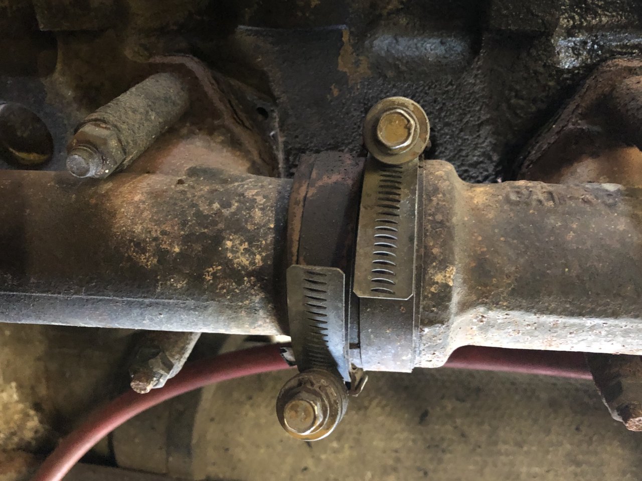

    The Cat C15 ACERT we have, the last driver made the mistake of taking the slip joint apart when he was replacing the manifold gaskets.
    That was a pain in the butt because we have two turbos to work with.
    He tried sealer, cleaning up the joints but to no avail. Black soot trails.
    Then he rolled up steel wool, wrapped them around the joint, took a stainless steel strip, wrapped it around the steel wool, applied 2 stainless steel hose clamps to compress the steel wool in place.
    Since then it’s been leak free even with almost 60 psi of boost.

    Here is the manifold of the C15 ACERT:
    This is steel wool rolled, wrapped, and a stainless strip wrapped around and banded with 2 stainless hose clamps
    MARE, joey8686 and Rounded_nut Thank this.

    Do you know what stainless strip he used?
  9. Shawn2130
    Shawn2130 Heavy Load Member
    896
    1,896
    Sep 20, 2015
    Southern Ontario
    Hello, I used thin stainless pieces that I cut from a sheet of stainless I had laying around.
    Basically the thickness of a furnace ducting for example.
    I used what I can bend around the manifold with my hands and wrapped it about a round and a half or two. Then clamped it.
    MARE Thanks this.

    And does that clamps still holding? No leaks since then?
    I'm having horrible issue with manifold joints, so I'm about to try this thing you said

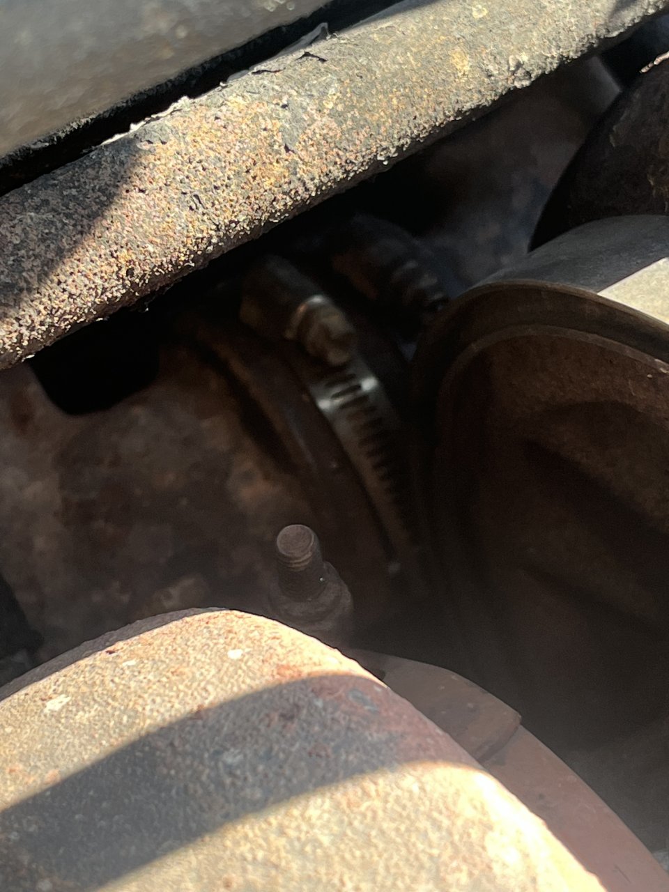

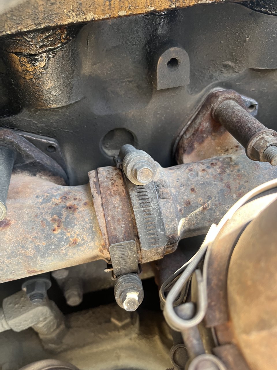

    I went out and took pictures right now.
    Since the 2 turbos make over 50 psi of boost, the manifold doesn’t seem to be leaking so far.
    675E82B1-6809-42C1-9FBA-47FBCBD57E7E.jpeg 508C4F27-6178-45FB-9FF5-FA247EDE0F14.jpeg
    When I had the engine overhauled the manifold pieces easily comes apart, which I think is old age. It’s still the original manifold with 1.4 million km on it.
    At the joints before, used to be all black from leaking.
