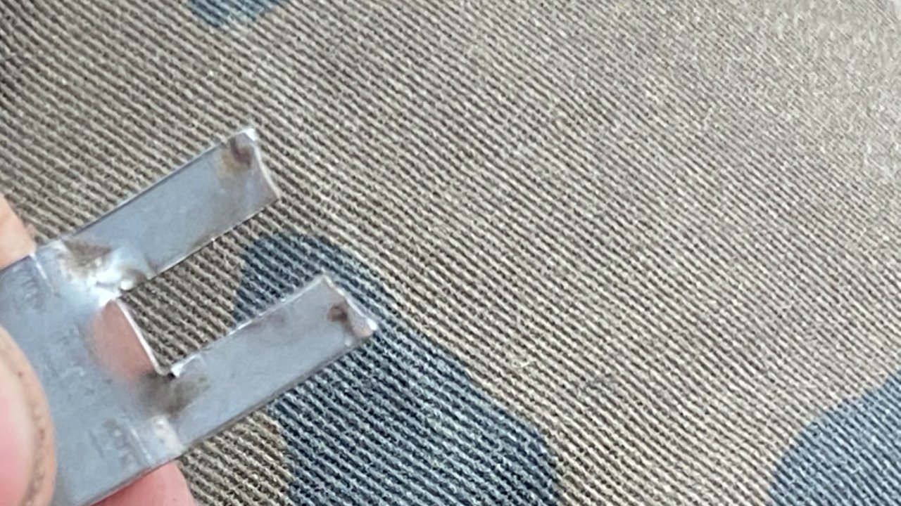

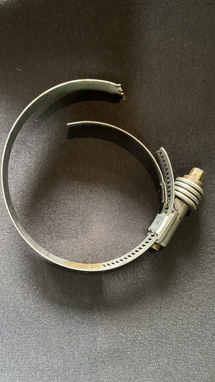

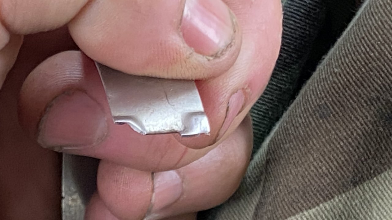

    Thank you so much! I'm doing the water pump this weekend and the hose on the bottom of radiator too.
    I had a hose clamp on the bottom of the radiator break today and that was fun.
    At least I was sitting in line at a customer.
    That's terrible that you had the one on the rear of the motor and one on the side break. Awful.

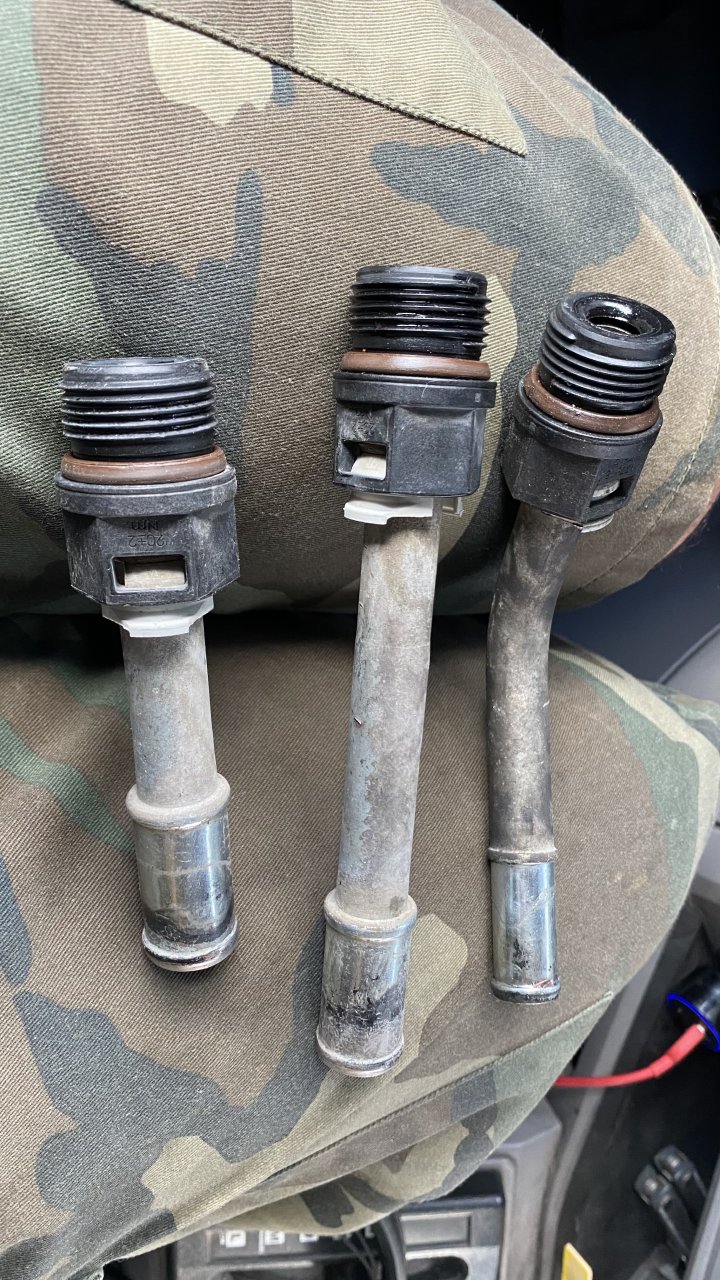

    I'm glad I'm swapping them out before they break.

    I gathered all the tools etc. Wish me luck
    I'll report back!
    I got some internal pipe wrenches from home depot.

  7. Goodysnap
    Goodysnap Road Train Member
    3,744
    9,105
    Jul 12, 2017
    Good luck.
    Have extra heater hose and clamps. The brass fitting is short and when you remove the quick connect pipe the old hoses wont reach.

    I did all three today and they all came out easily.

    I got all three out today. They were all easy to remove and didn't break.

    Ty. Thankfully I remembered to buy more silicone hose!
