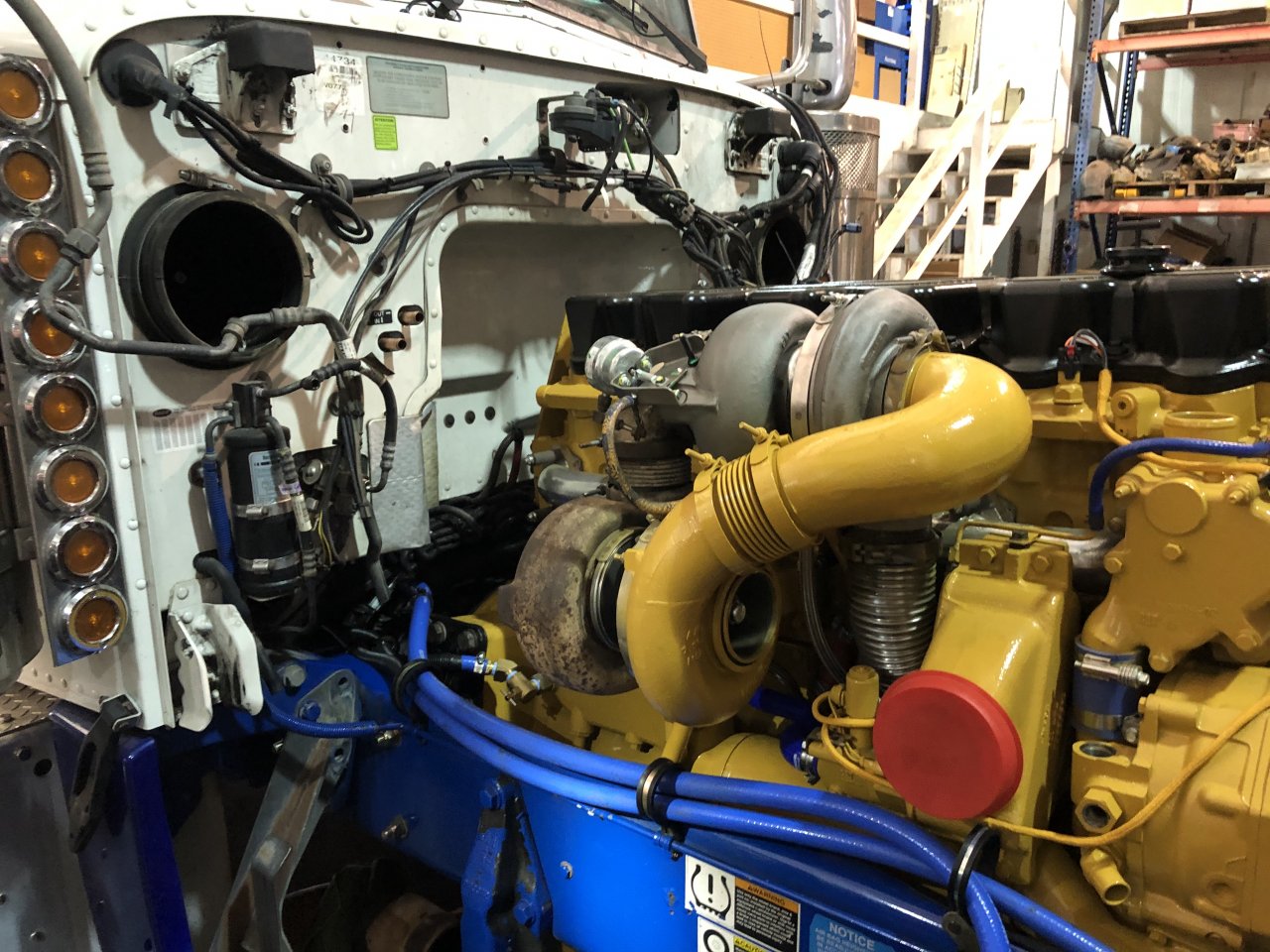

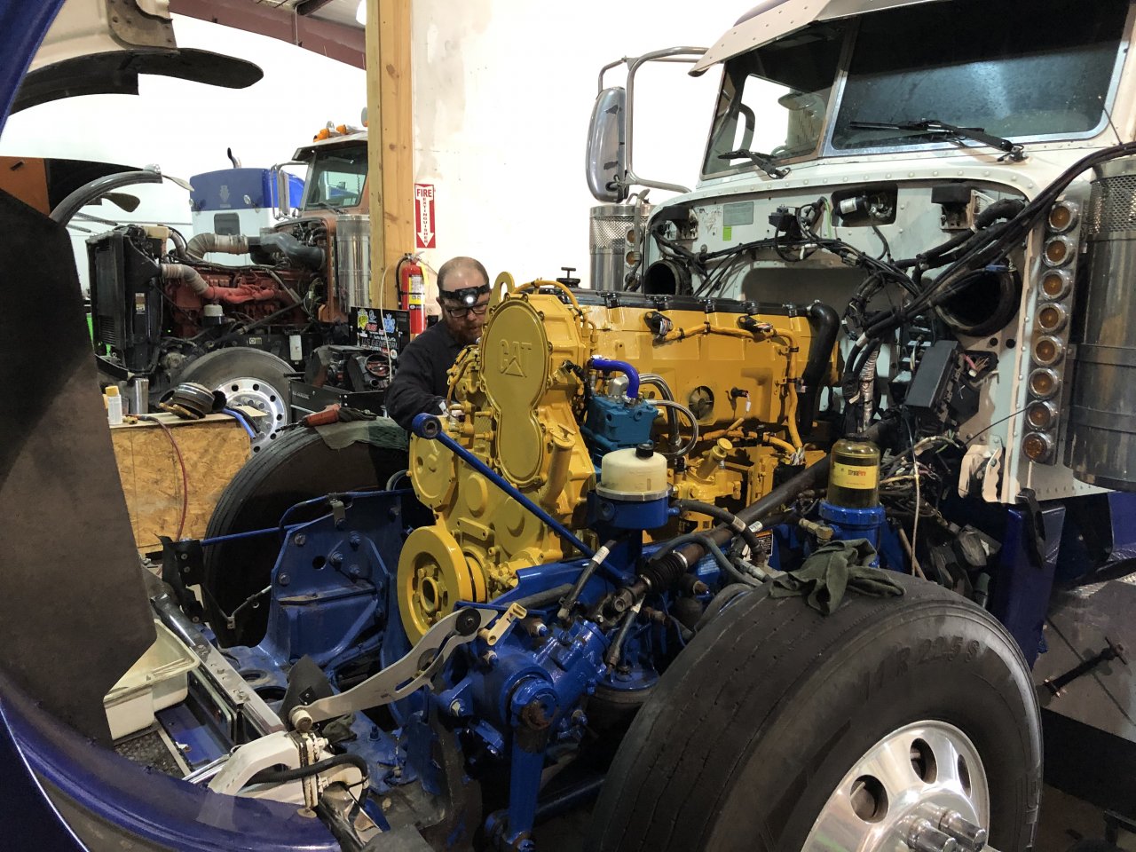

    I used to think the 6NZ was the be all...end all of Cat engines. In 2011 I purchased a 2007 W900 with an NXS Cat. I was reluctant because I’d heard all the bad things about ACERT’s. My mechanic, who is one of the smartest Cat ECM gurus I’ve ever spoken to, told me that the ACERT had more potential than a “stinking” 6NZ (he figured out how to tune an ACERT before PDI taught the likes of Mr.Haney how to do it). He tuned my tired ACERT to out perform my 6NZ. Fast forward to 2020. I wanted to repower my 2014 ISX15 (POS) powered 2014 389. To a CAT......I’m going ACERT! 625 guts, 15:1 pistons (yes factory Cat, one piece steel) IVA delete, gawd knows what ecm software he’s concocted, pre 6NZ injection timing, prolly a 625 cam, 625 twinkies, injectors?!?!?
    He says it’s gonna run smooth, no black smoke, fuel efficient........but only 700 horse. 21154E53-1674-49CD-978C-01C4B13BCA68.jpeg 18443CE8-2381-492B-AF4F-CF7FCAB09043.jpeg

    I'm surprised you are still using the pre cooler?!?
    spsauerland Thanks this.

    I asked about it. Frankly forgot his answer. I’ve learned to let him do his thing. I still want to know where to find 15:1 factory ACERT pistons that he claims are in there. He bought it as a “platinum” kit and had to dismantle the packs because he doesn’t like the factory oil rings they came with
    lester and AModelCat Thank this.

    I asked today. His reply was: “Why would you want your intake temp to be 200 degrees hotter?” He thinks it’s foolish to delete it with twins.
    Shawn2130 Thanks this.
