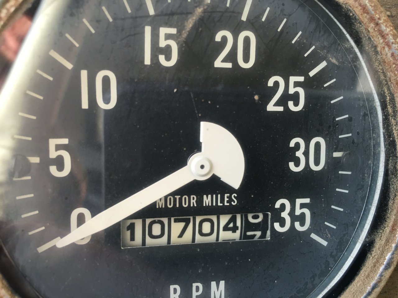

    Another dumb question:
    There are three counters.
    1. mileage. 242,xxx
    2. hours 2,394
    3. engine miles. 10,xxx
    What are engine miles?

  7. DL550CAT
    DL550CAT Road Train Member
    1,427
    1,482
    Oct 18, 2009
    Waynesburg, Pa
    Is number 3 engine miles or revolutions? I drove a Mack that counted revolutions.

  10. DL550CAT
    1,427
    1,482
    Oct 18, 2009
    Waynesburg, Pa
    My guess would be revolutions times a number like a 1000 or something. I can't remember what the Mack I drove had on it. It was revolutions x1000 I think. Anyway being on the tack the only thing it could count is how many times the engine has gone 'round.
    After thinking about it, it was times a hundred. But that does not jive with what you have. It would mean yours has an average rpm of about 450 based on hours and tack.

  11. BIGZILLA
    BIGZILLA Heavy Load Member
    758
    1,318
    Oct 15, 2015
    Treasure coast, Florida
    That sounds about right. It spent its life hauling water on a farm, moving slow over short distances.
