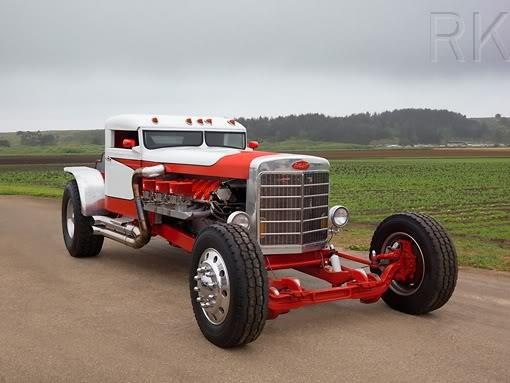

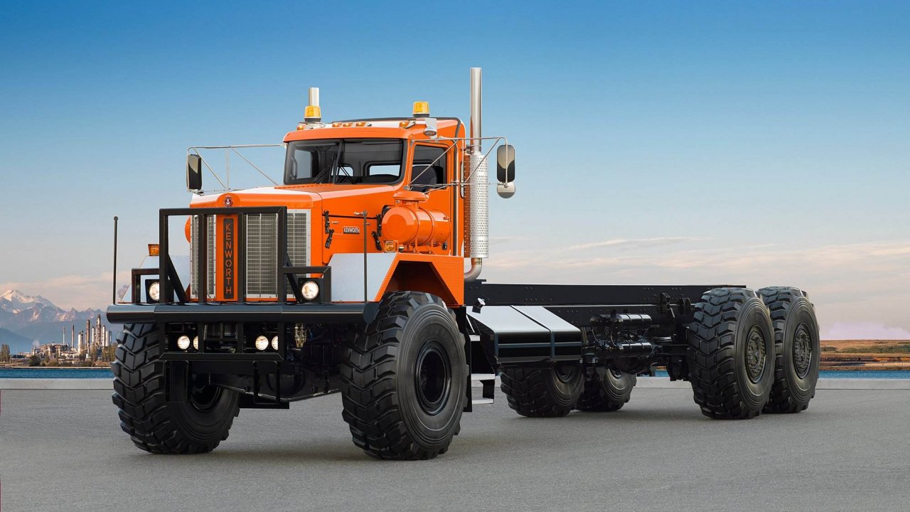

    how but some that have been "destroyed" LOL
    IMG_0149.JPG IMG_0150.JPG IMG_0152.JPG IMG_0153.JPG IMG_0154.JPG IMG_0166.JPG

    The last two you posted are actually factory Kenworth's, both are Kenworth 963's, heavy duty off-road rigs, primarily found in the middle east as ultra heavy oilfield rigs out where there are no roads. The first photo is an earlier photo of a truck built by a Canadian custom shop, Quality Custom of Brampton, Ontario built it. The yellow and black as well as white and red were built by the Blastolene Brother's, the remaining few I don't know much about. I've seen the heavily chopped, channeled, and sectioned one that's as a rolling chassis, but, I can't remember the shop building it, but, I believe it's out of the PNW.
