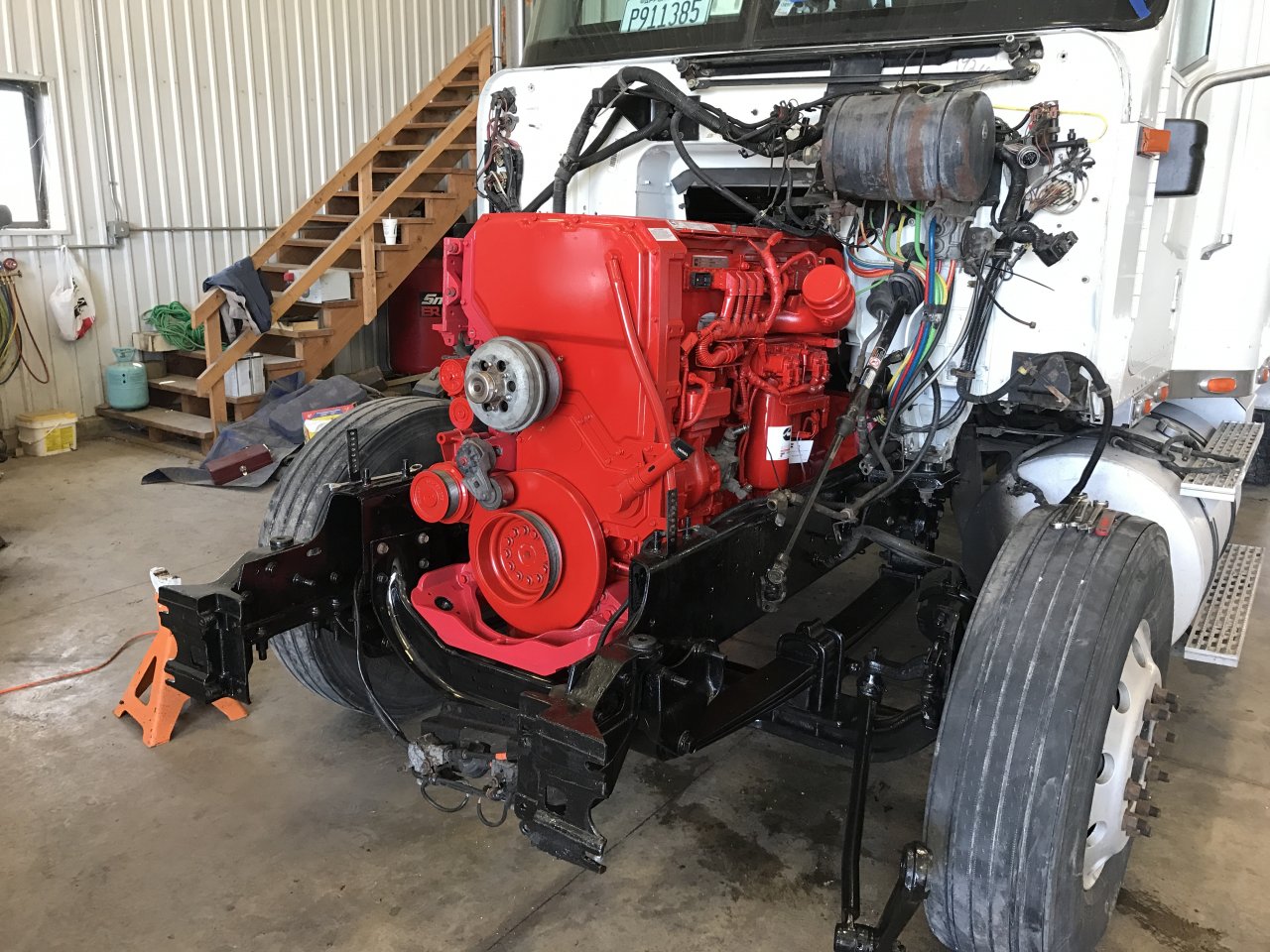

    $22500 but did it myself.
    Now after a year and a half and 150k miles I’ll say maybe I should of just bought a NEW truck.
    No way I would put a new motor in a 2009 truck..... when all said and done it will still only be worth $15k if it was done by Cummins. Not a Cummins rebuild its worth $10k. I thought I was smart because it was a 2001 model year I may be worth a little more? Nope.... it’s still only worth $10k
    Still stand by my decision but I do all the work myself but, if you don’t or can’t do the work yourself just get a new truck. No question. C0C2BE42-5233-465E-B28D-E617D52E968E.jpeg 3D8C43B2-8D72-4534-B625-929B8813C250.jpeg
    Also the quotes you got for the work will grow once they crack the first bolt. That bill will just grow and grow and grow....
    What will you do if the final bill gets to be $50,000.00 and they still are not done with it?

    I started with a bare block on a '08 Pete, and I sit $30k over budget and just starting into the interior. Still cheaper than a new glider, but despite the fact that it feels like I've replaced EVERYTHING, there's still a lot of old parts.
