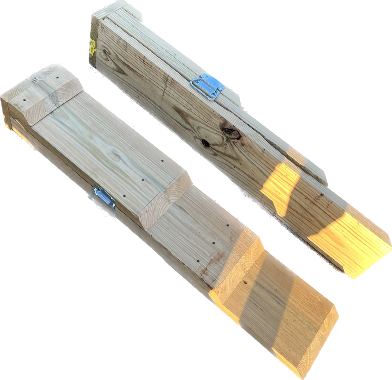

    I think I am going to do 40-50K oil changes in the future.
    No need to go longer I guess if I do them myself.
    I can make some ramps from stacked 2x8's to get under.
    I just hope I don't strip the pan bolt, since its plastic.
