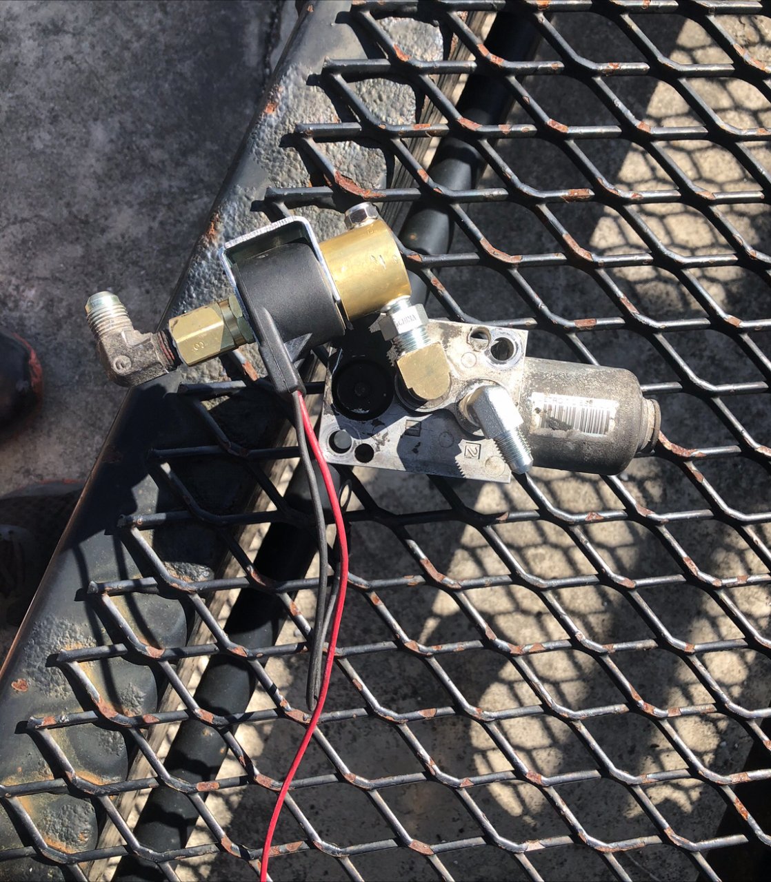

  8. Hulld
    Hulld Road Train Member
    2,882
    6,561
    Oct 19, 2015
    Upstate NY
    Here is a picture of the solenoid installed on the Vpod before I put it back on the truck
  9. FC2007
    FC2007 Bobtail Member
    6
    Jul 12, 2020
    Thank you good man but i owner this truck for the last 4 years, i have changed the VPOD twice and i don't have that air solenoid at all. I guess now you know which bush the rabbit is lying in.
  10. Hulld
    2,882
    6,561
    Oct 19, 2015
    Upstate NY
    You will NOT have an air solenoid on a stock set up like yours.
    I added the Solenoid myself to get rid of the Hissing noise the stock set up makes
    FC2007 and AModelCat Thank this.
