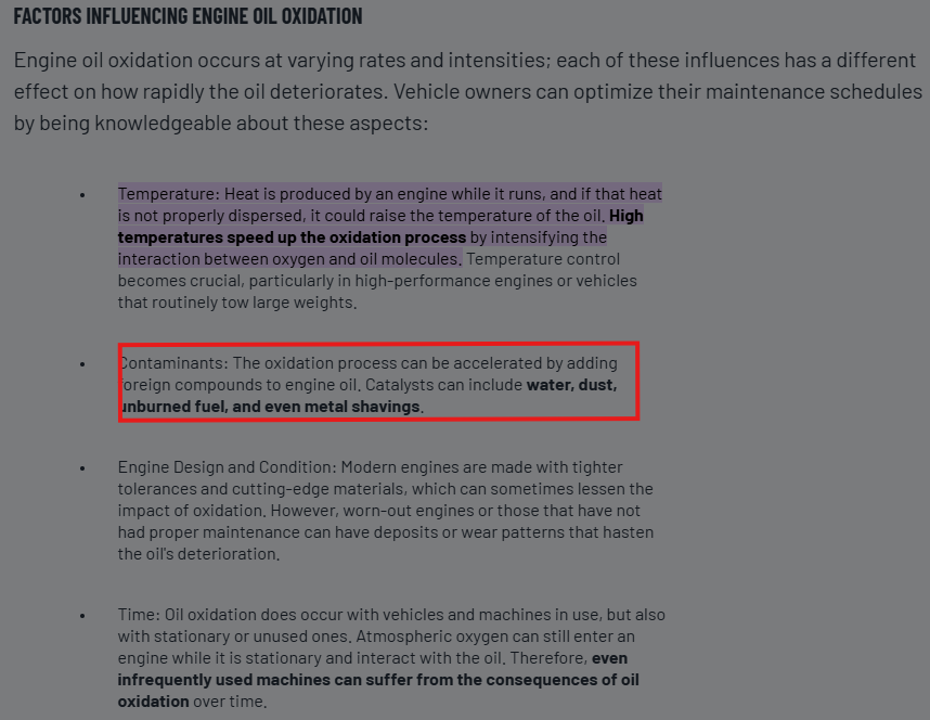

    With it being much colder when you changed to the 5W-40 did you idle more? Cold starts during winter weather would also put more unburned fuel into the oil.
    Oil when opened is good for about 2 years. When unopened and not exposed to extreme temps (say in a shed exposed to freezing temps or summer heat) it is about 5 years. One thing that can happen is that the additives separate. I recently did a lot of reading on this. One source is Lake Speed aka The Motor Oil Geek who did a you tube video on the shelf life of oil.

    They use alot of road salt in areas you run? If so fine dust will make samples come back abnormal. Change air cleaners and re sample oil when next due
